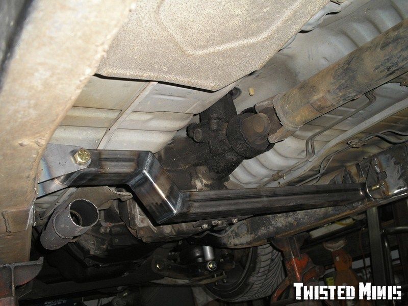

I know you said funds are tight, but if you want one right now is the time to order one. I have an existing order that is going out next week, and the material is supposed to be here tomorrow so I could build them both at once and you would get it quick. They usually end up under $200 with shipping. Just an FYI. If not, here is a shot installed:  It leaves just over 3" of room for exhaust when the bottom is level with the frame. You could push it up a bit more if you needed the room, as the mounting design is friendly to change, but it is going to raise your transmission more. It already lifts it about 1/4" to begin with.

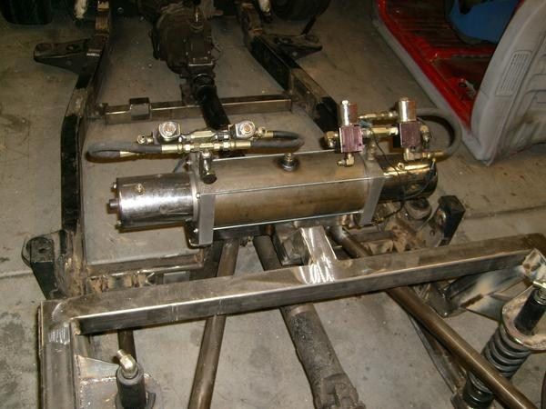

Modified CanDo unit,for exhaust & e-brake!
