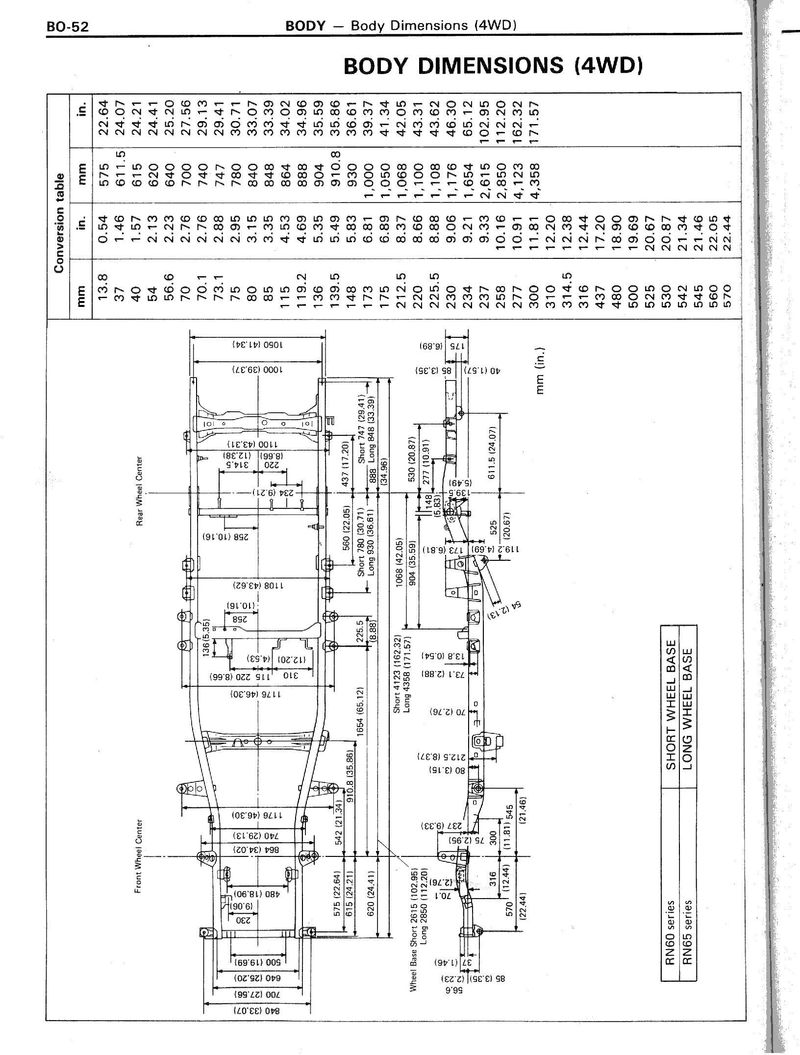

it may not be exactly what you need, but it should be the same body dimentions I beleive, I will re check my work computer if I get some time tomorrow.

Hey thanks alot!! Yea im just not sure if the 4wd dimentions are any differnt at all from the 2wd chassis. Dont really want to take a chance. But that is exactly what im looking for that exacxt layout just 92  2wd. Any idea where to locate them. Thanks for the help ma i really apprciate it.

everything is the same just the frame is taller

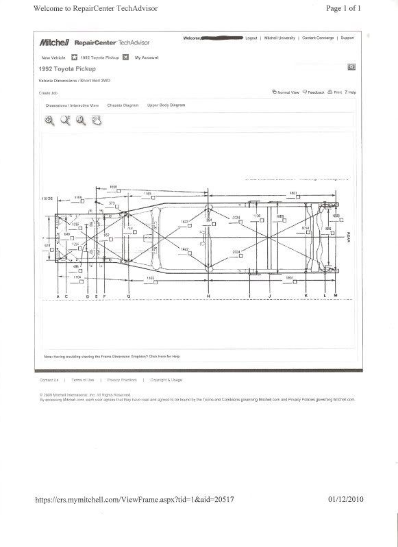

i have the proper 2wd 1992 pickup frame specs. I'll post it up later tonight, I have to scan it into the computer. -Brad

here you go, hopefully it helps.

---------------------------------------------Originally posted by slammedcivicsihere you go, hopefully it helps.  ---------------------------------------------Do you have anything like this for a 1994 T-100?
