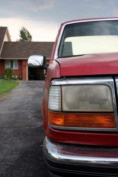

A little while ago, I picked up a 92 flareside for a project for my girlfriend and I to work on together. It had front end damage, frame was bent, the stock 5-litre hardly ran and the tranny tail stock was cracked, but for $400 I couldnt complain. The plan is to build a frame, stcok floor bodydrop, do a diesel swap, and turbo it. Its going to become my daily driver when it is finished. It will probably stay on the original rims but with slightly smaller tires to fit under the flares. We started on it as a Christmas break project.
The Victim
