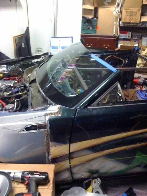

---------------------------------------------Originally posted by low99mazlami is easy to cut....you just cut both sides along the same line then make it "run" actually breaking the glass...then you can either use a razor to score/cut the lamination/plastic in between the glass or light the seam on fire and let it melt the lamination enuff to bend the glass apart at the cut then cut the lamination. The hardest part is to not get any "oysters" or chips along the edge of the cut---------------------------------------------sounds easy but its really not, i called alot of custom hot rod shops, and none guarantee it wont break, and allwanted at least 600-700 to do it, i found a guy in the bay area who did it for 500 and he has been building hot rods for 20 years and cutting windshields for that long, and even with that much exdperience it cracked when he first cut it, so thats why we cut 2 more inches off, so the concept of doing it is easy but trying not to crack the windshield is hte hard part. and ive seen others cut and they are not straight on top, thats why most people put a molding back on. but i didnt want a molding on top, and the cut had to be perfect.

O i know its not easy to do i have been a glass technician for 6 plus years.......even flat lami cut go wrong on you!! Any good glass man will not warranty a cut becuase glass is so inconsistant.....easy to cut easy to f up...haha. Car is lookin really good

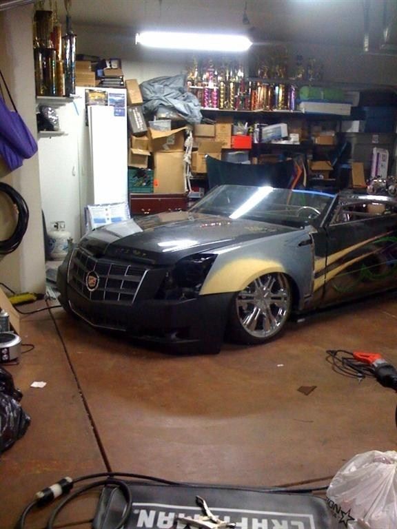

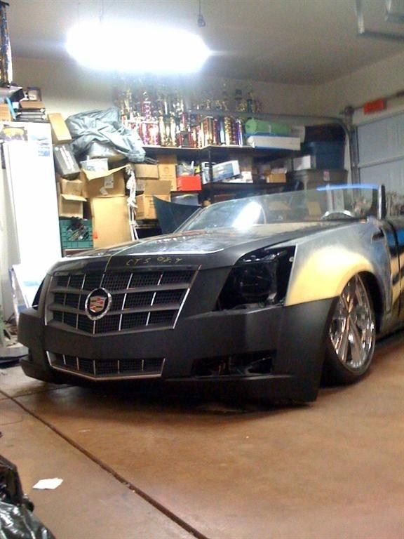

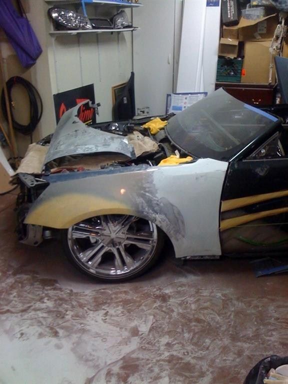

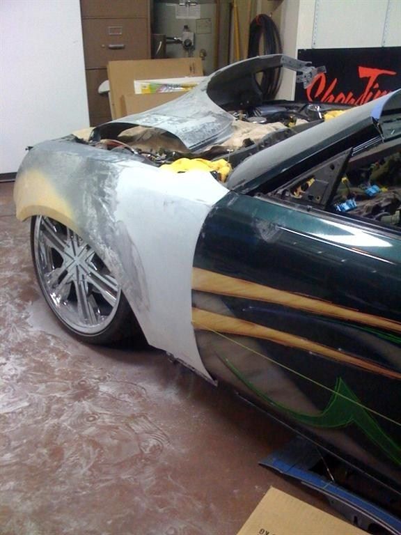

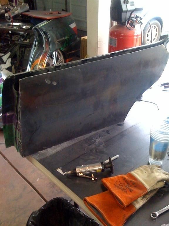

update: we started body work on fenders not complete, still need to mess with body line, and hit other fender, but here is a rough idea of how they will look, also i finished capping the first door and it came out nice so going to hit the rest of the doors, in a few days

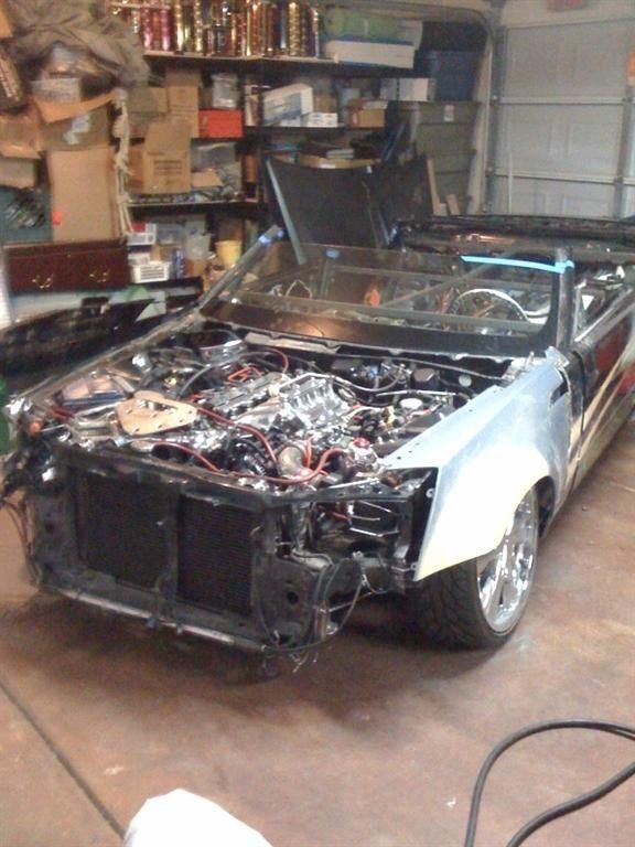

Well as far as the build i had to take a break on the car because i re opened my shop and have been real busy with getting everything situated still in the middle of getting it all done i hope to have it up and running by the end of the month at which time i will trailer the car over here and get back on it the goal was danger zone but not sure if its gonna happen ive been so busy working on customers cars that i havent had much time to work on mine but with the new shop i will be back on track and having more room helps im real tight in my garage so soon as i get back on it i will post some new pics thanks for the intrest
