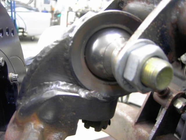

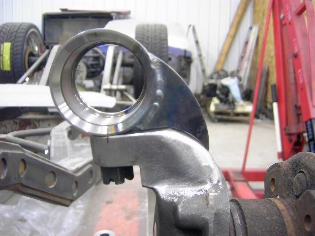

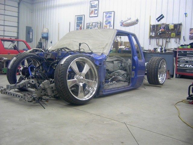

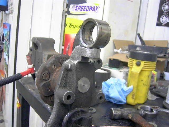

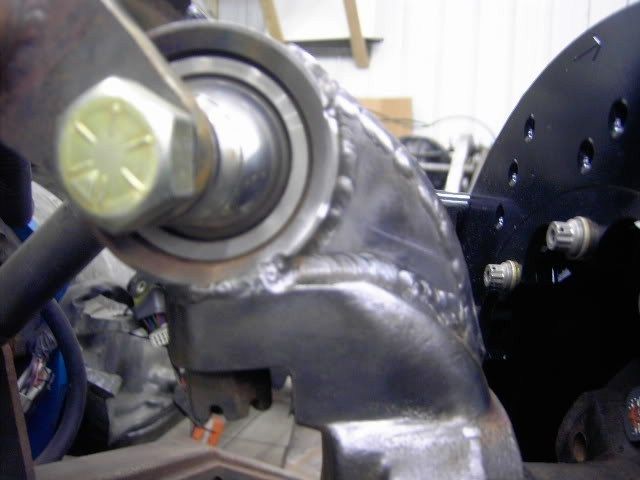

This is how i did mine. I cut the taper part off an old ball joint and tig it to the bearing cup to set it up on my spindle. Made some other pieces to weld to the cup first, so it will also have more area  welded to the spindle. That way the bottom of the cup is not the only space welded to the spindle. Giving it more support. Mine is fully welded and bolted also. I had someone with experience help me tig to the spindle. I would never weld to cast without someone with the experience of doing so. Only reason I did this is because I could only get 10" of lift with the stock toyota upper ball joint. Stock toyota frame with drop spindle should lay out on 22s just wont get enough lift to clear fenders.i     Last pic is on the old frame.
