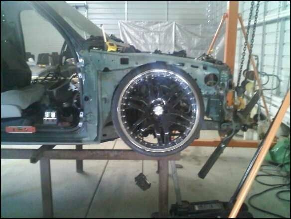

here ya go this is a taco i did about a year ago. Set up for 22x8 with only custom made control arms and spindle spacer. Layed true frame with the front cross member sectioned and the rack moved up.

this is my daily laying true frame the same way but with a 20x7.5. everything else is stock.
