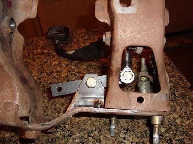

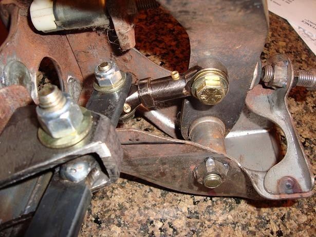

do you think this will work. I have thought of a lot of ways to do this but I think this is the cleanest and simplest i can come up with. let me know what you think.
getNlaid621
that heim joint linkage is going to connect to the pedal in the hole that the clutch master cylinder linkage bolted to.

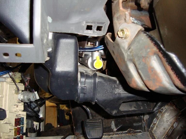

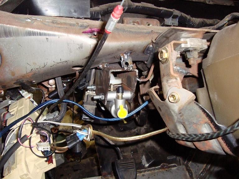

  This is it so far. Im waiting on my wilwood master cylinder. so far its going good i cant wait to see how it works

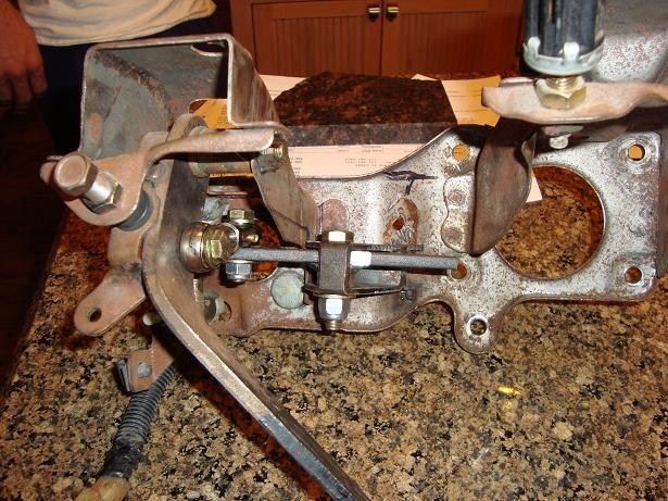

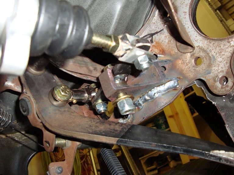

here are some pics of the master cylinder bracket tacked in and the pedal assembly bolted in to see how it works.
