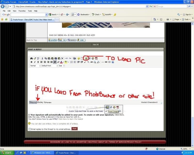

how do i put the pics on here
DOWNSUB's avatar
DOWNSUB
Edited: 10/18/2009 10:27:06 PM by DOWNSUB
DOWNSUB's avatar
DOWNSUB
--------------------------------------------- Originally posted by mmautoworks how do i put the pics on here

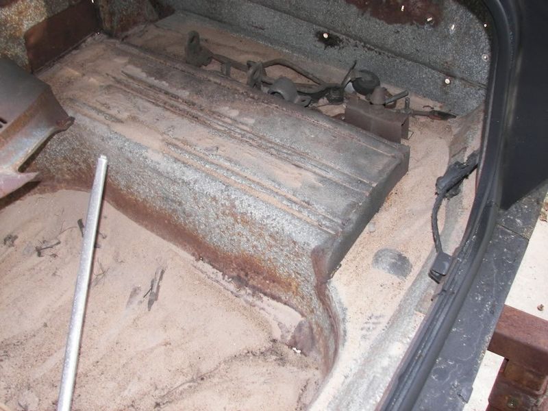

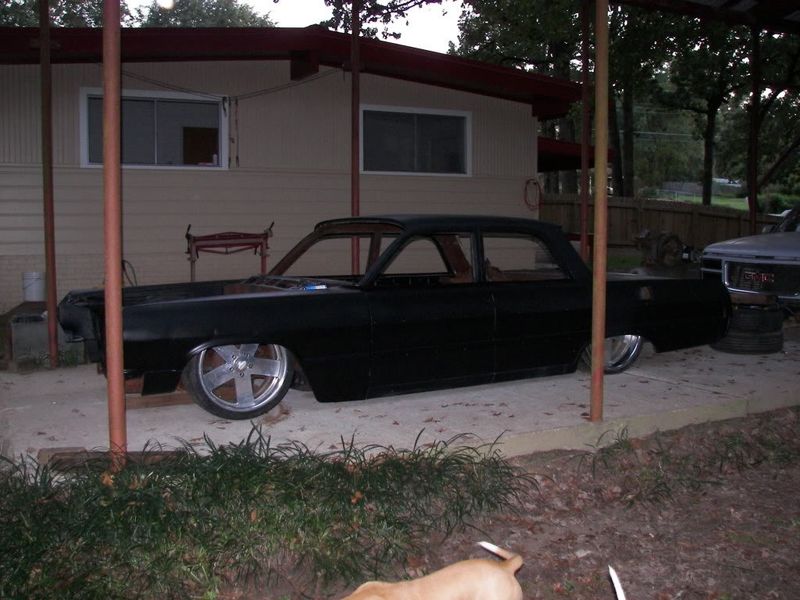

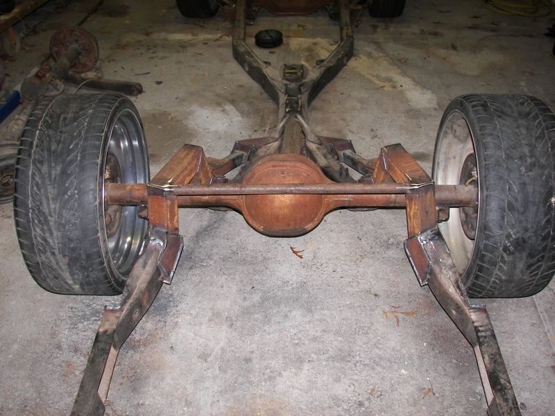

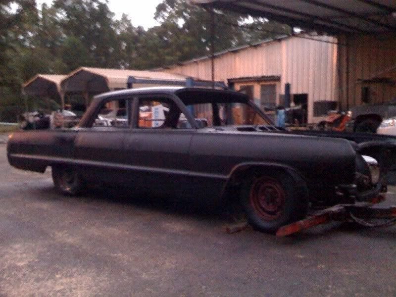

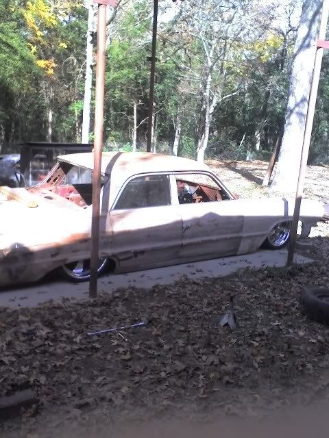

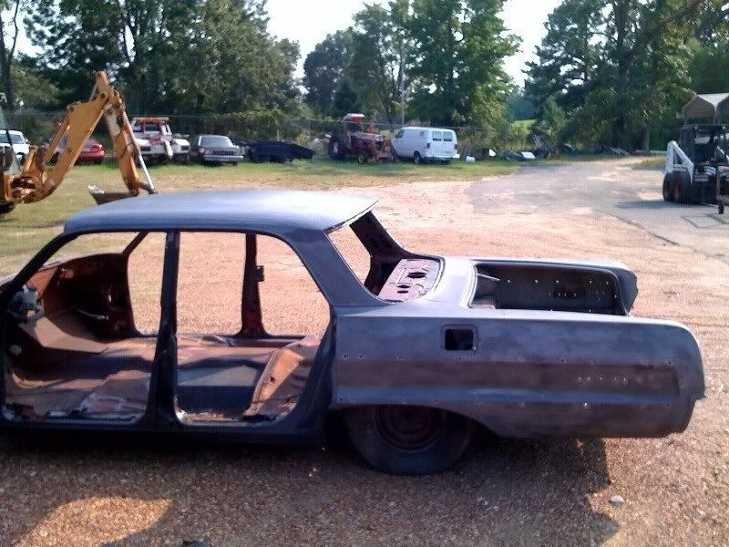

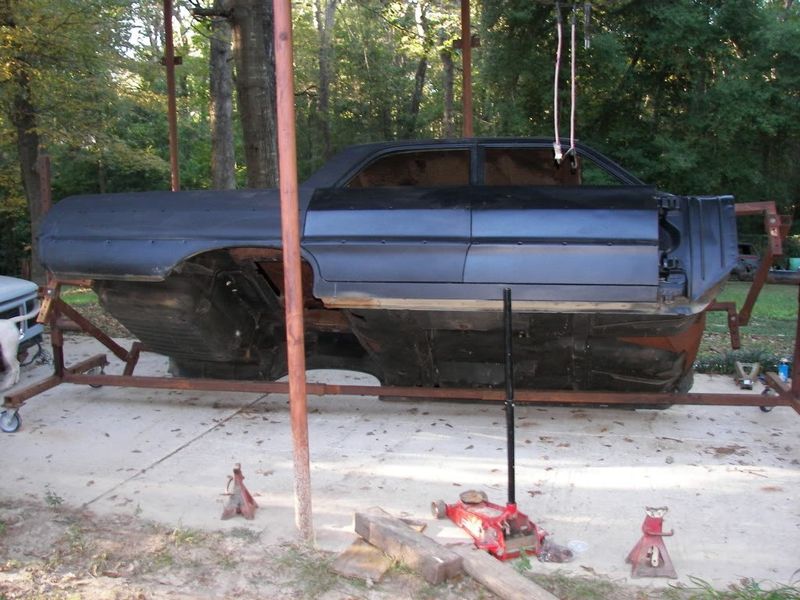

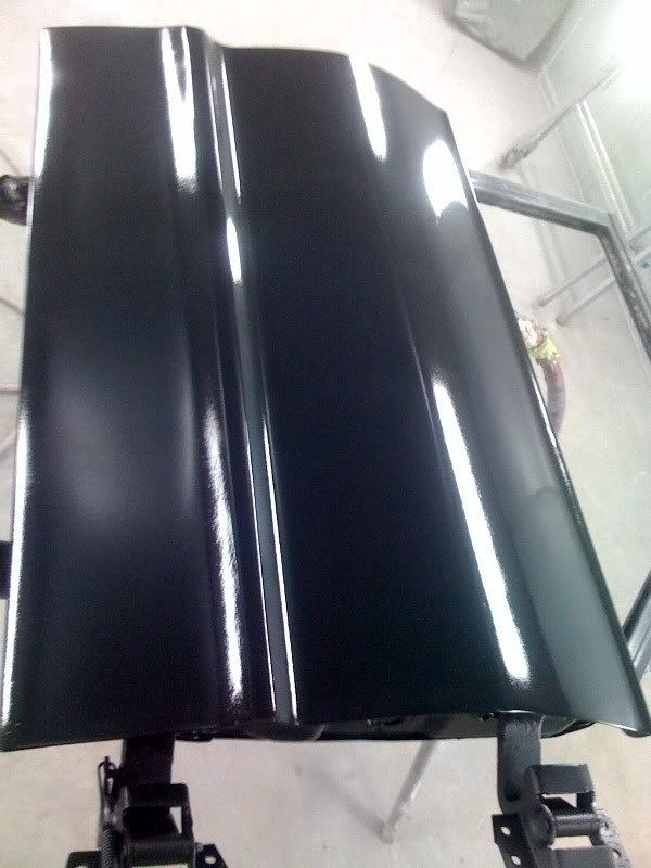

awsome well let me post them on here then this is my 64 belair that i recenly purchased when i got it ,it was already bd and set up for air the bd was incomplete the front uppers will not work and the rear setup needs to be redone   here itis the day i got it stuck some 18 and 20s on it just to see it laid out

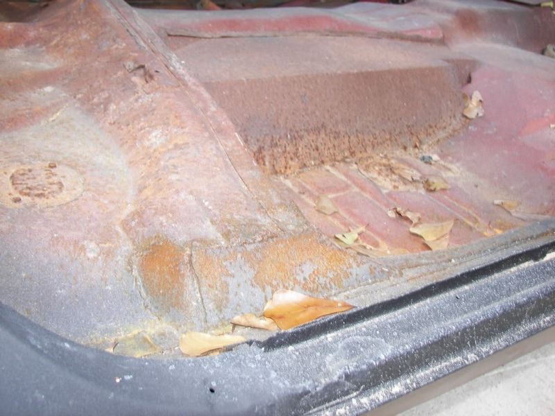

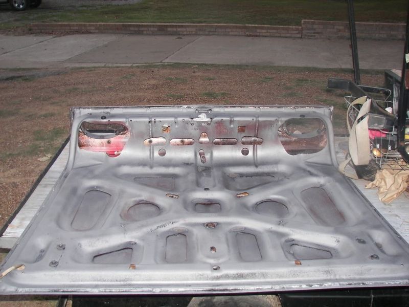

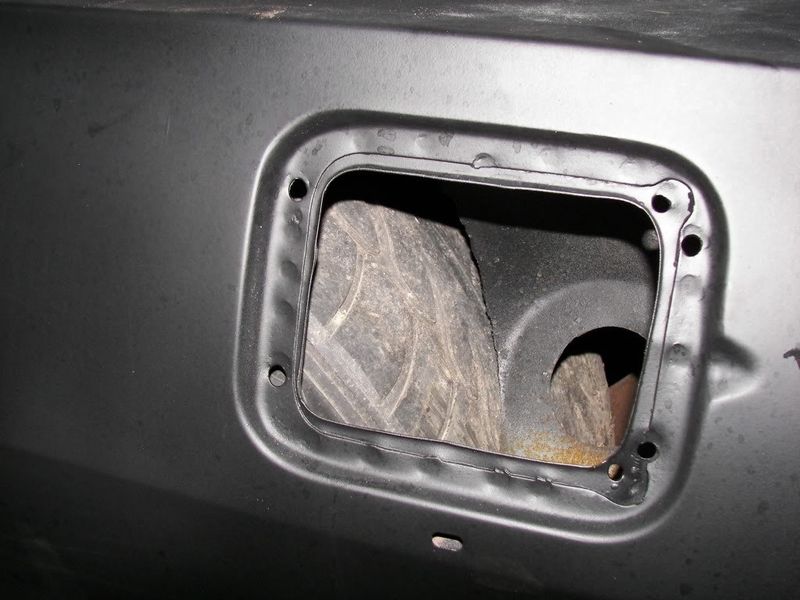

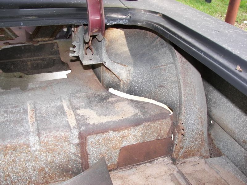

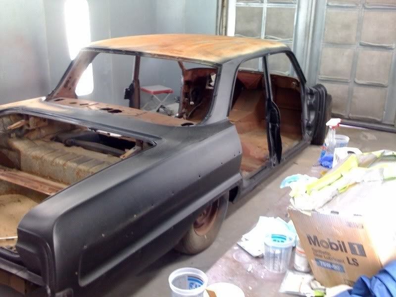

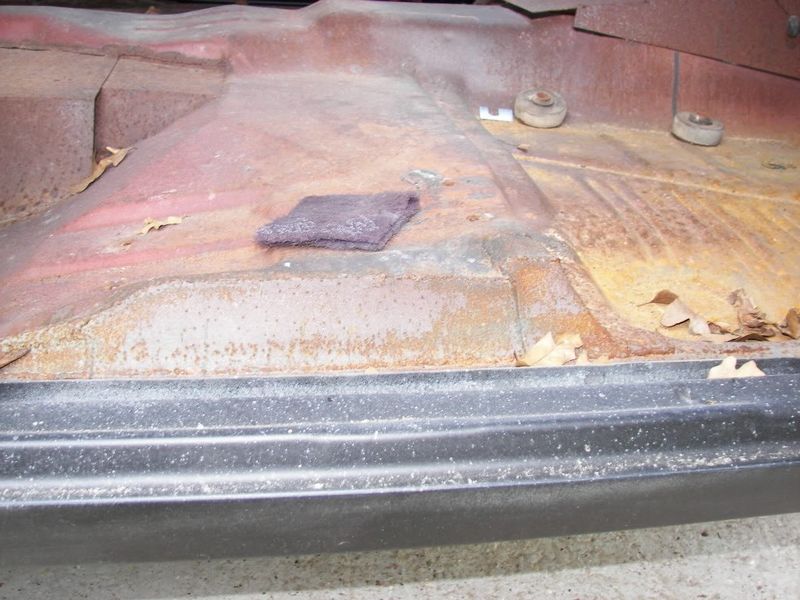

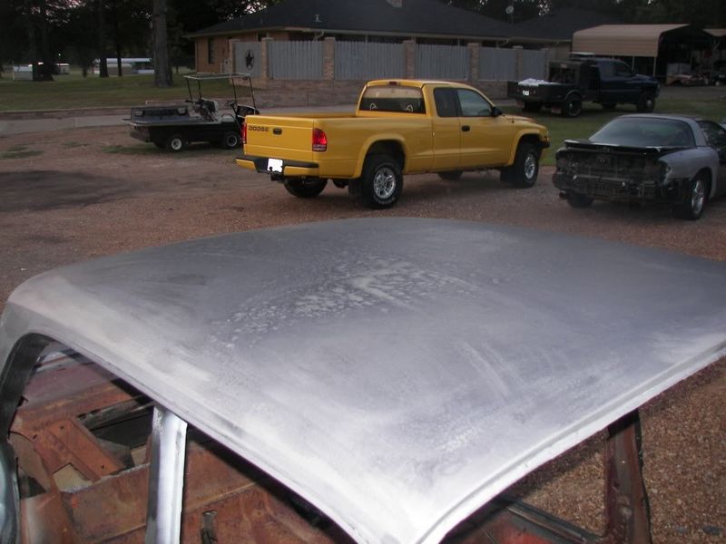

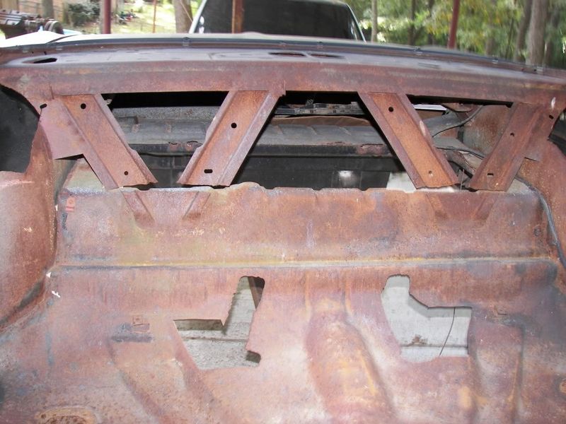

i sand and soda blasted the whole car on the out side and treated it with rust killer for the pits in itremoved all the body filler on the car all of the trim holes were bondo no welds and then etched and epoxya few pics with the 20s and 22s before i pulled the frame it was about 2 inches from the rockers need to trim more out of the body

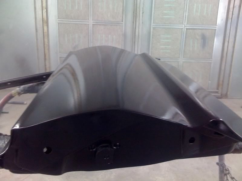

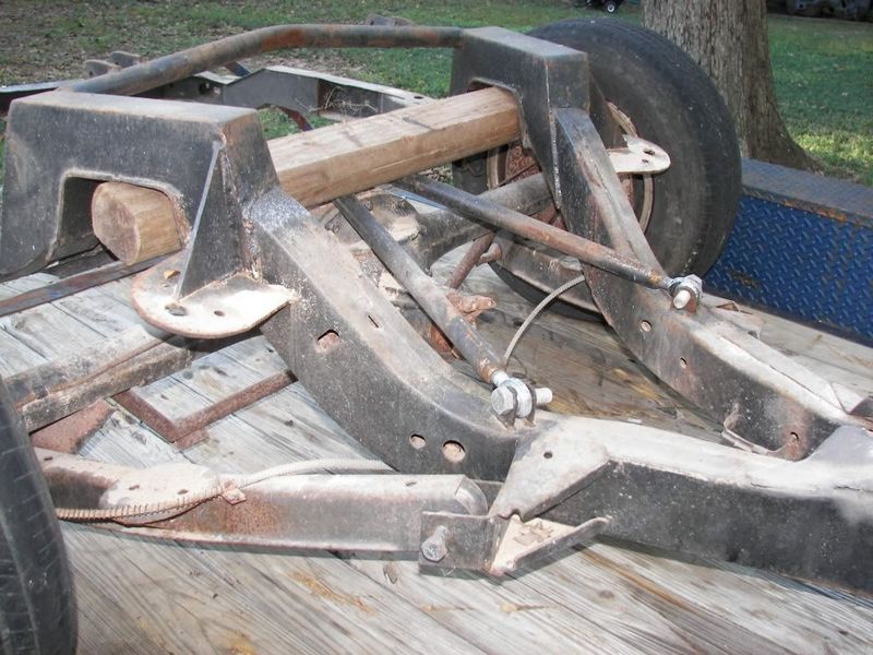

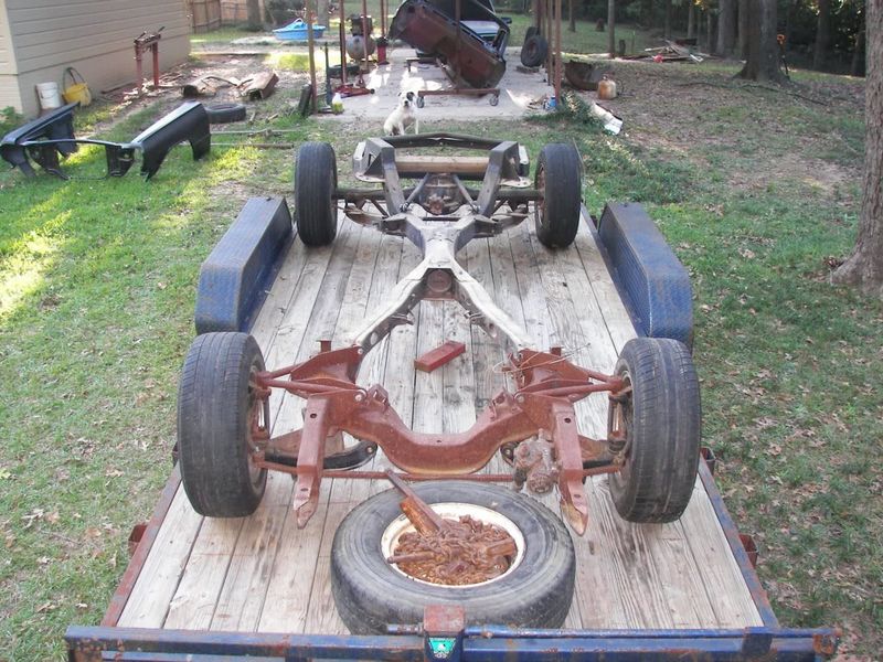

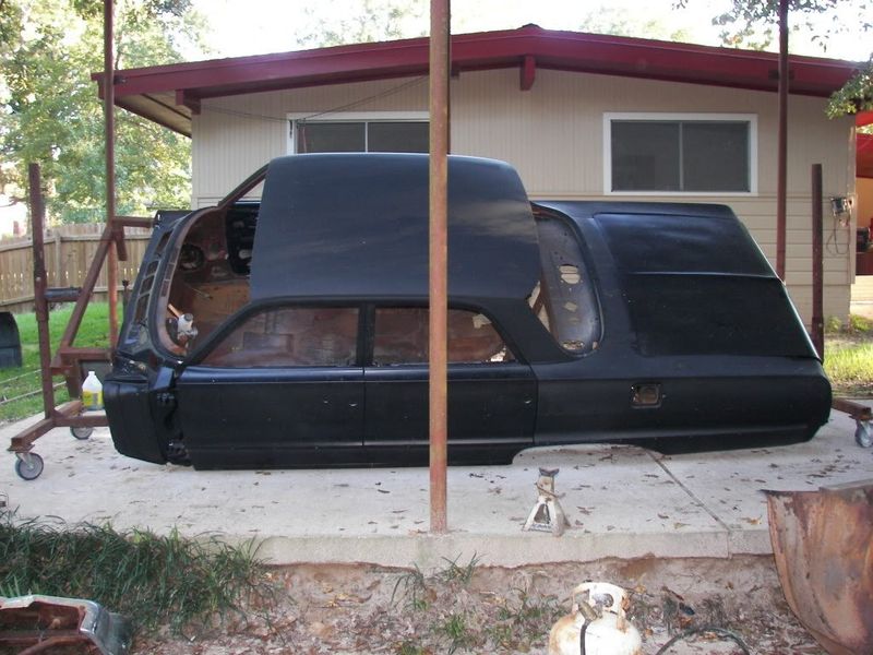

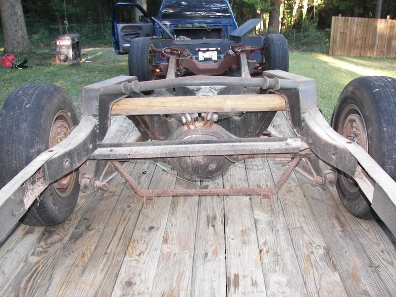

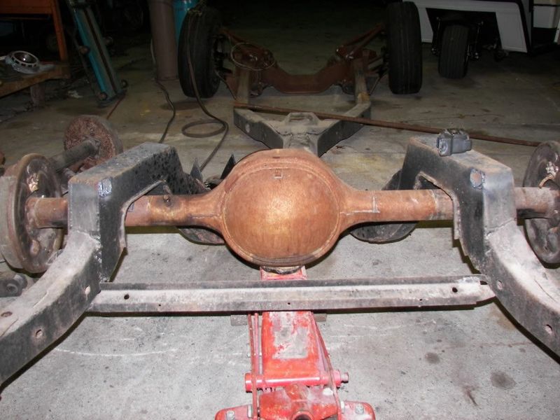

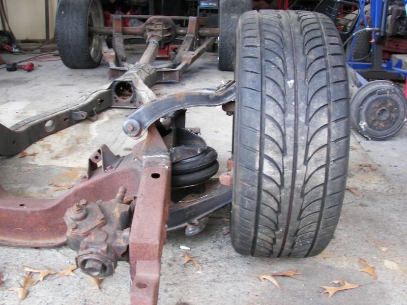

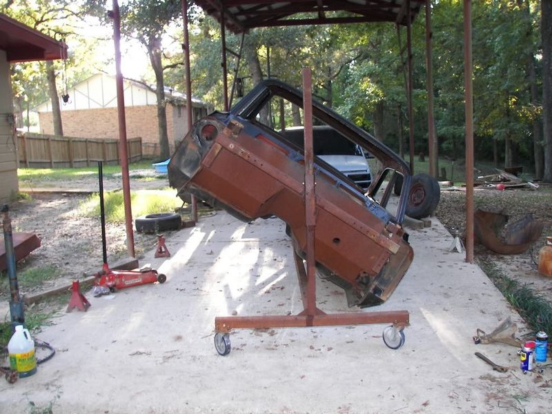

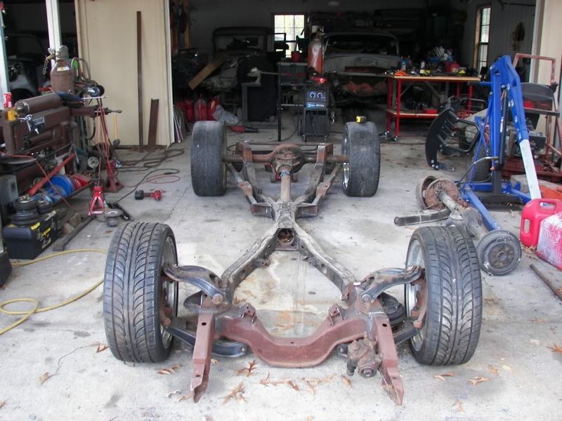

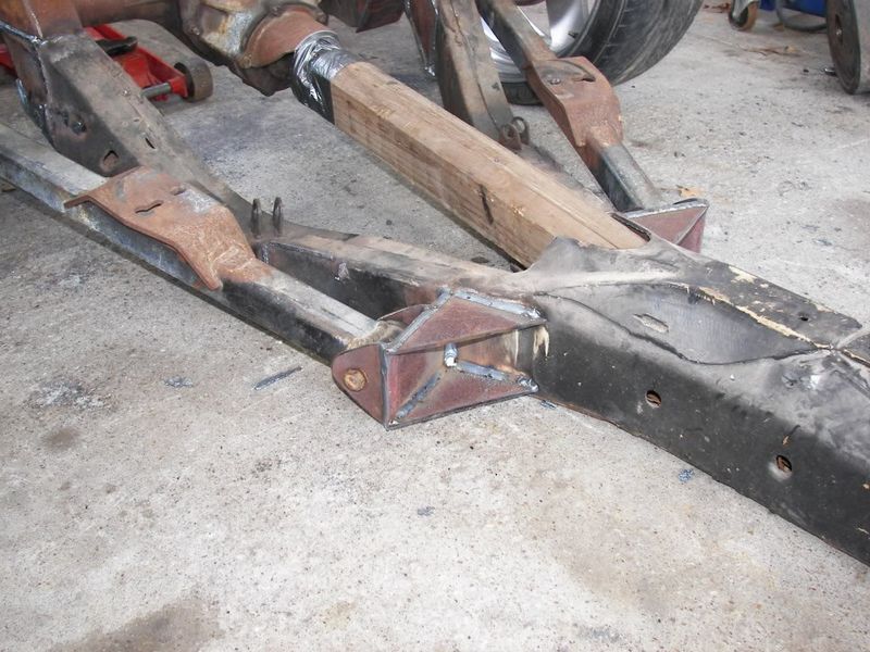

pulled the frame for susp rebuild and got the body on the rotissarie so i can blast and coat the under side finish the floors and start body work while i can turn it on its side to make it a little easier on my back
