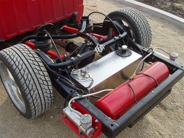

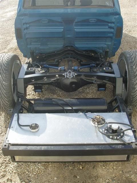

All you need to do is weld a flange with the same bolt pattern to the cell you want to use, be it custom made or from summit, etc. As long as the new cell is deep enough. This is one I designed and had fabbed for a customers 92.

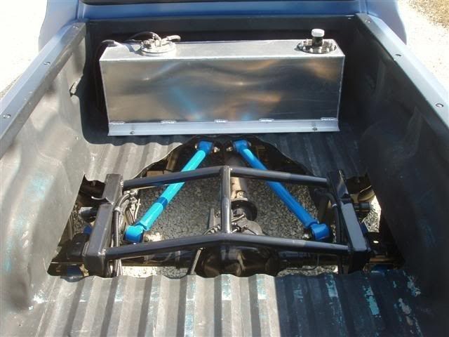

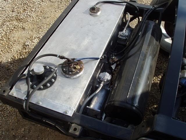

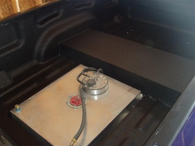

You can also do this on trucks with pumps that usually lock in with snap rings etc. In these cases you make a 2 piece adapter that just clamps the flange of the pump down: Ranger: (this one was bought, first one I used and started making them afterwards..this one had to be tall to make up for the tank depth and I dont really like the look so now I just make cells to match)  2nd Ranger, custom cell and adapter: S10:
