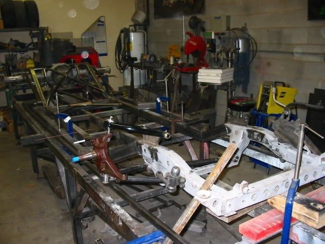

cold_carcass
Use the stock Toyota steering/link and run drop spindles with custom arms.  Here's mine.
