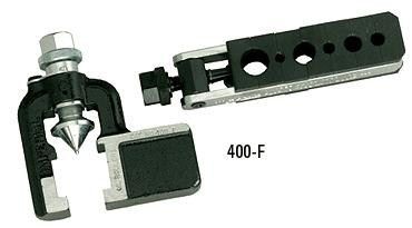

  That looks like it is a nice flare tool but $1000 is a bit spendy. And I thought I was being a baller when I bought  a Hydra flare. I got this one
