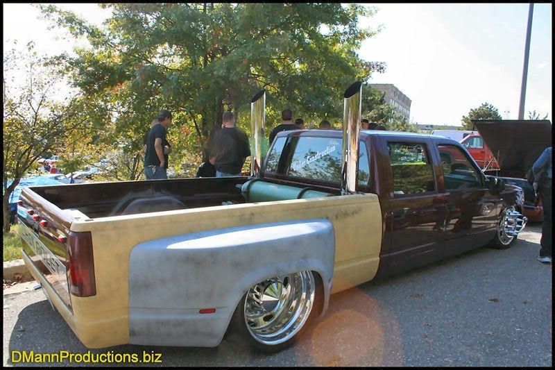

back pressure is your enemy in diesel applications exhaust temps are the devil so bigger is less is less do a 4" turbo back into some sweet stacks hahahahahaha
