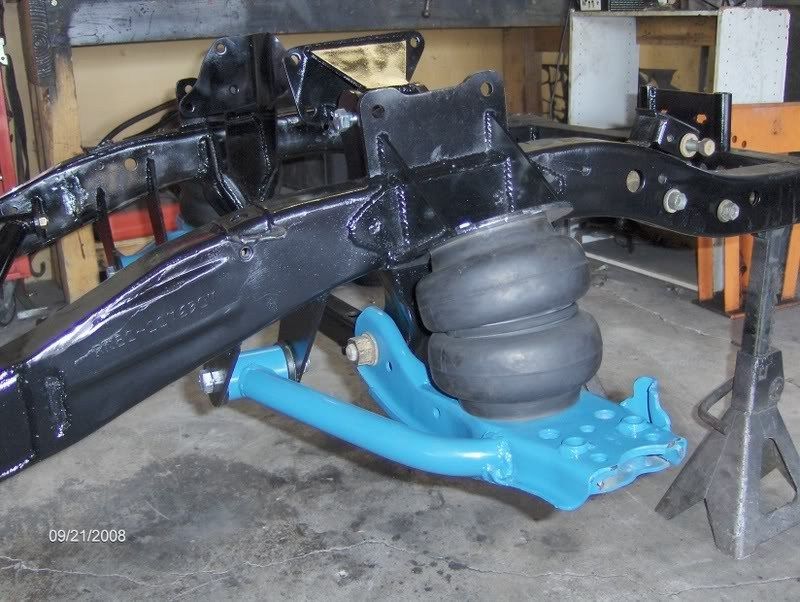

i finally got the yota clip and now i need some pics of bag  brackets and i also noticed the uper control arm is going to be in the way of the streeing shaft comming out of the streering box

I'll try to get some pics of how we routed the steering on my truck. Essentially what we did was use 3 joints. It went toyota steering box to smooth weld-on then a double weld-on to mate with a weld-on to a Ford D joint. We also had to use 2 heim joints to stabilize the steering.  Here are some pics of the bag brackets that were built for my frame.      If you want to see more pics of the truck and the build so far you can go here..  http://s71.photobucket.com/albums/i141/myth619/willtruck/
