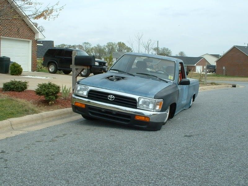

I have a 1989 Toyota pickup and would like to do a front end conversion to a 1995 Toyota 4runner. I have the bumper, lights, lower valence, etc.Can you please tell me anything specific that I need to do and what obstacles I need to look out for? Pictures would be a great help! Thanks        Skyler

The grille and fenders will bolt right up.You will have to modify the core support a little for the headlights but nothing major.The bumper will also bolt up.You will need the outer bumper brackets from a 4x4 or 4 runner also.I have no idea what the guy above me is talking about^ lol

Get the grill mounted first, without the bumper.  Then fit the light to the grille.  I mounted the lower mounts first by drilling holes into core support and using sheetmetal screws.  For angle, use washers as shim.  Then remove grille and mount top.  I would recommend removing clips from grille for easy in and out.  Takes some fitting and cutting, but works great.  You can buy the connectors for the 4runner lights at any auto parts place if you need them.  Like 5 bucks a piece.
