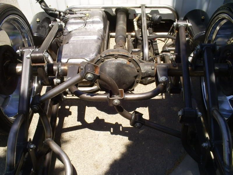

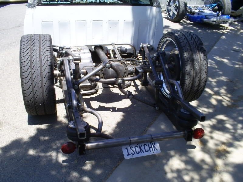

theres a few pics of it in the new Street Trucks ans says it has "3 Watts links"..theres also a close-up shot of some welds that look like swiss cheesesome sketchy work

man thats a doubleknottedtrippleunderlaycantileverymagillicutty link. special order! instructions not included.

The whole shackle thing on top of the axle, has me scratching my head??????  I now have a headache.

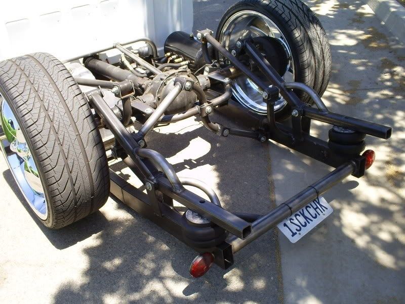

It is a 3 watts setup, so basically the axle would travel near vertical just like a watts keeps the rear from shifting side to side. Really sketchy looking fab work though. The 2x2 looks like shit going to the bags like that, and none of the tabs are radiused? Welds are questionable too. Neat idea bad execution.

there is one set of radiused link tabs! find it its fun, like wheres waldo but with metal

I think its the tabs there but i cant really tell. I would hate to see that thing on the freeway, all the tabs  look so thin. It could cause a chain reaction when something breaks on that setup.

her name is "1sckchk", totally cool girl, has been working on her truck for many, many years now. heres a few i found on her myspace and some i had at various shows. trucks now chop top'd & doored on 24"s

Because it has 3 watts links keeping the axle front to back and left to right it moves completely straight up and down. Now everything else that travels in an arc has to ride on shackles because otherwise it will pull the axle. The watts links keep the axle from rotating.
