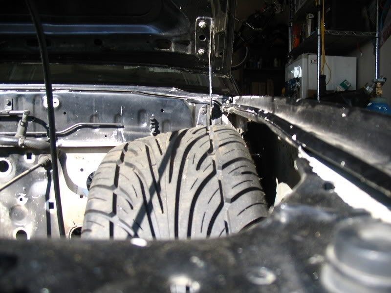

---------------------------------------------Originally posted by tuckntiremazEdited: 3/19/2009 11:44:07 AM by tuckntiremazUnless you want to run the GMC 20's or a custom set of billets go 5-lug. When looking for a 7.5 wide wheel you will want 5 inches of backspace MINIMUM. 4X4 sheetmetal will not help you when you are bodydropped. Once you get to that upper bodyline 4X4 and 2WD sheetmetal are the same. Your tires will be hitting the the hood bracing at a 2.5 BD. with a 225/30/20.---------------------------------------------ummmm. . .   i disagree. . .   I am bodydropped 3.25" with 225/40/18. . . Thats less than 1/2" from bein the same height as a 225/30/20. .   And I have a good inch or so from touchin my hood. . .     -Josh

Your right Josh, I was thinking of a 255/35/20 that I was going to put on my truck a few years ago. opps I stand corrected.
bodied b2600zx (josh)
cool man. .   jus clarifying. .   ya a 255 35 is a beast. .  hahaha -Josh
