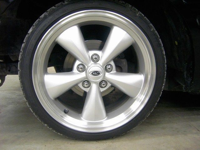

I have 96 tacoma thats BD with stock arms and rearend I was wondering if  a set of 17x8 mustang bullet wheels will work and still be able to layout

definitely not. Those sound like they are rwd offset and will stick out WAY too much and definitely hit the bed sides.  I had 18x7.5 on my taco before my 18/20 combo with 35mm offset and they tucked nicely.

If your talking about the newer mustang bullet wheels they got a high offset and should tuck fine.

god i love those wheels. i totally want a set. try the v6 17s. same design, but in a 17x7.5 with like +42.
