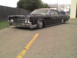

im about to start a 1965 project lincoln continental, does anybody know if you just use cups in the front?? maybe someone has pictures of a build of one. Thanks!

flat plate on lower arm and cups on top will allow you to lay on a 20 if you want 22 you will have to mod your lower arm so you bag can sit down inside it. the rear is real fun because the car is unibody you will have to plate the body where you want to attach items such as shock mounts, bag mount, you can do 4 link but its a pain to do unless you have a lift. 2 link much easier. have you tried finding basic parts yet? such as brakes, etc? good luck.

i did this 66 and yea i did cups on top and flat plates on the lowers and trimmed a lil and it layed out nicely it was easy except it took forever to get it apart....and with 22s
