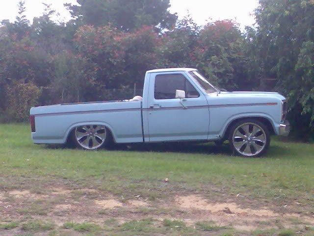

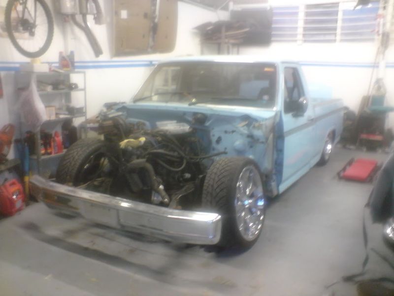

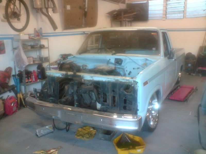

I have just added my F150 to my profile with pics of what I have started to fabricate.
I have mounted the brackets off the radius arm /Ibeam bolt but I wasn't sure if that was what everyone done.
My plan is to loose the original spring seat ( I have RE7 )and design something so I can bolt the original gear back in if required.

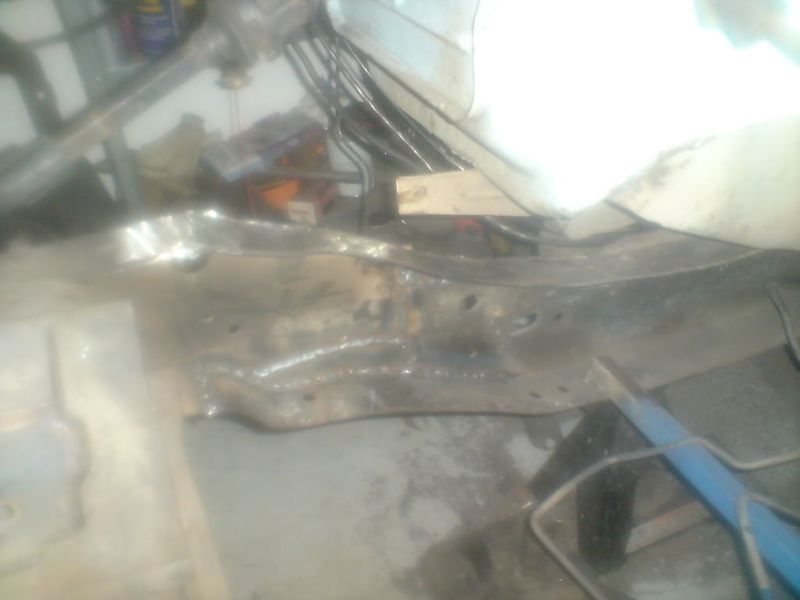

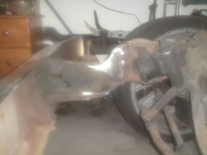

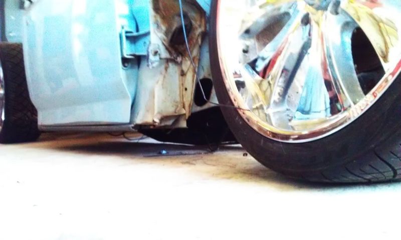

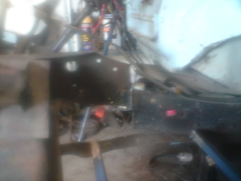

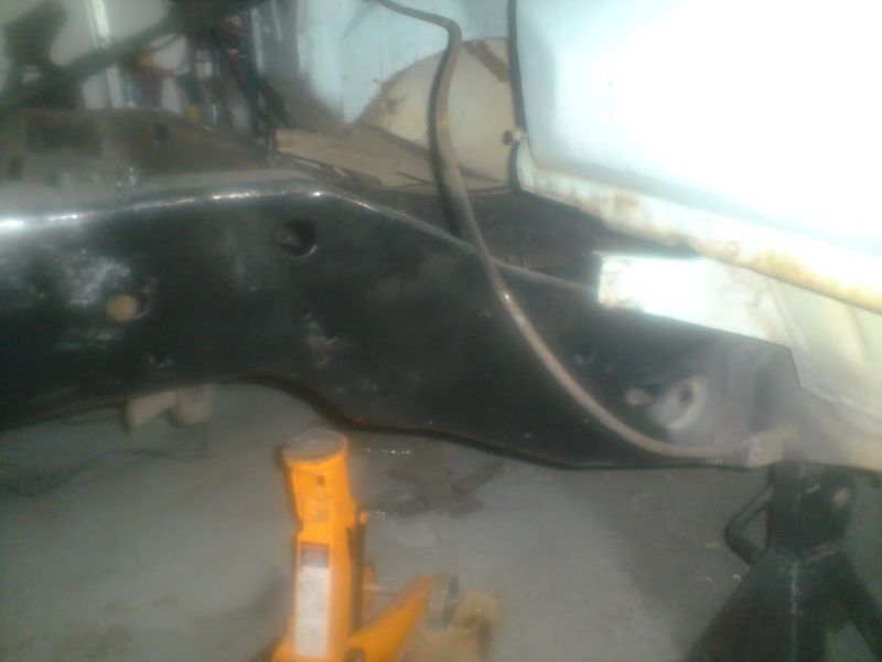

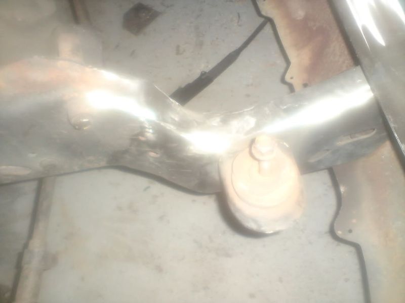

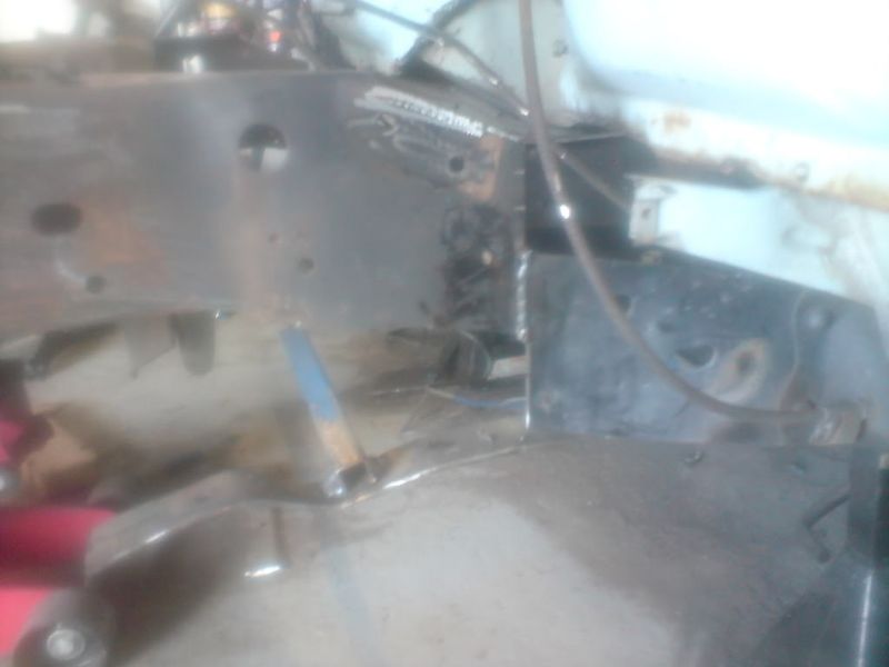

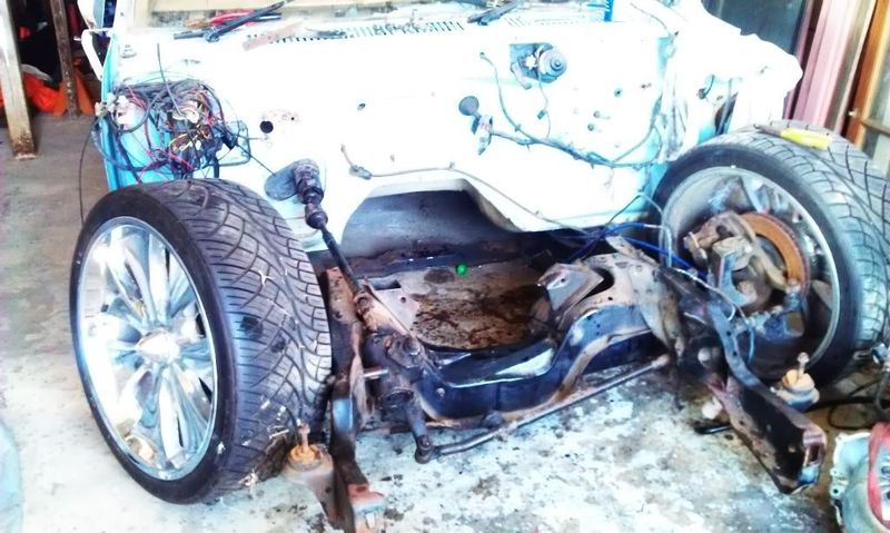

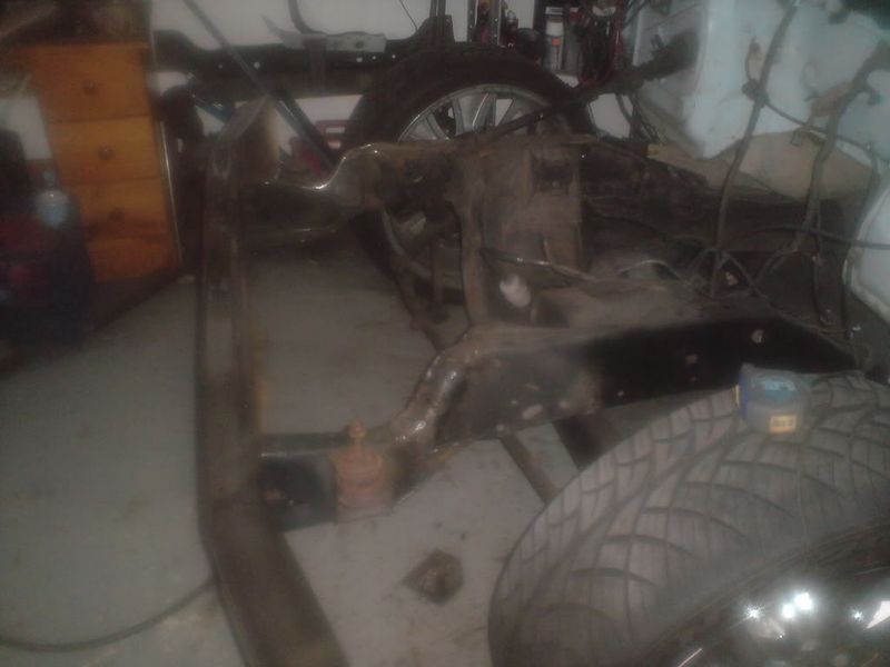

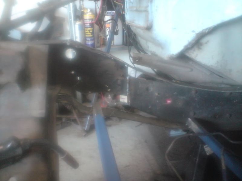

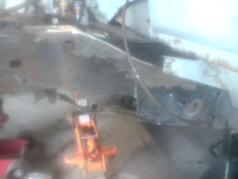

I just finished the "Z" on the front of my truck took me about eight hours all up I'm now in the process of Z'ing my rear half as I couldn't bring myself to cut up the tin work I'd already done out the back. I tried to get it to look as factory as possible by blending the top and bottom of the chassis rails into the "Z" the only place it doesn't look factory is for the front frame horns/radiator support mounts as I needed clerance for the steering.
Gareth I'll PM you my mobile number so you can come check it out if you want.
I've got more pics just have to upload them to the computer, sorry bout the blurriness but my phone lens was a bit foggy as I'd been swetting my a*$# off cutting and shutting my frame.
