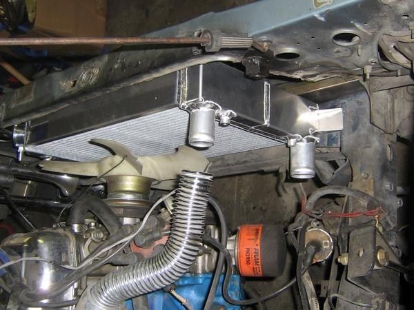

imade a recessed pocket in the front crossmember for my radiator. you can also look in summit. they carry alot of diff size universal radiators
Bush
thanks guy for all your input, i did a little research and found that an isuzu amigo radiator 88- 93 is a inches smaller and it fits like stock one. i'll let you guys know how it works out.

I also droped the core on my truck with the body drop , it was way easier than cutting the frame horms and worring about the strut rods.. i called up summit told them my dimensions , and they found me a four core aluminum radiator that fit perfect with room to spare . which also has enough cooling capacity to cool a 302 ,350 whatever youwant..
