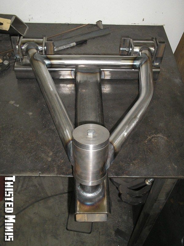

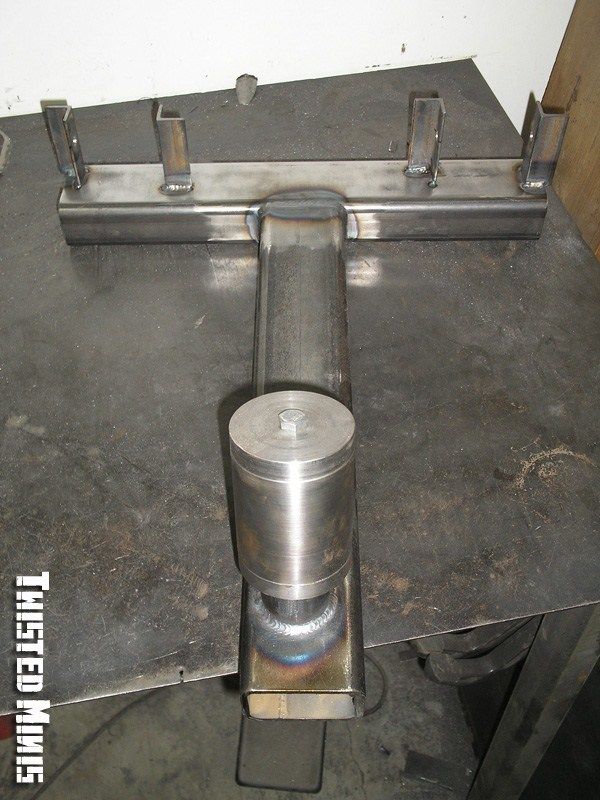

Heres some more jig stuff. I use solid steel bushings to keep the sleeves in place. I don't have any tube stands on this one to hold the tubes in place, because I build a mirrored image of the arm on the same jig.
