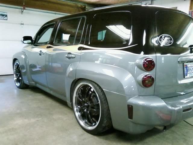

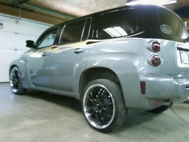

mreed
I am not entering an opinion of pro or con for 2-links but has anyone ridden in an HHR? They have 2-links. Call it a control arm, trailing arm, swing arm...whatever, it's a 2-link. As a matter of fact, the design is the same as the 2-link in the very 1st post.
I bagged one recently and thought about changing it but decided to see what it had to offer. I have to say I was rather impressed but that is probably largely biased due to the fact that I have witnessed so much 2-link bashing on SSM.
I can assure you that it is not a two link. FWD cars that use a beam rear axle have twist in either the beam or the trailing arms or both. Sorry, unless you design a rear axles with a pumpkin that will twist and allow articulation, its not the same as a thick walled 2 link.
