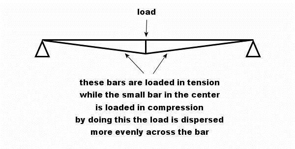

I recently did a piece in MiniTruckin' about material strengths and this is what I ran for bracing a bending load. The bushings are probably not going to be up to the task (at least not for very long) but you can keep the bar from bending.

Why won't the bushings be up to the task?
What bushing would you recommend?
Thanks.

I'm sure that they would put up with a decent amount of abuse, but I have to assume that they will wear out sooner rather than later.
