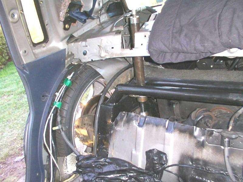

heres some arms mifiastylebitches made for his 93 towncar.
and heres the rear of pinchplayers 94 towncar. its juiced and might be a little more work then what your looking to do but it looks pretty low.
2fast4usdime
That is perfect Thanks for the pick.. The rear is exactly what Im doing but on air. I shouled be starting in about 3 weeks so ill put the build picks up.. And any other picks you guys have wouled be great..
