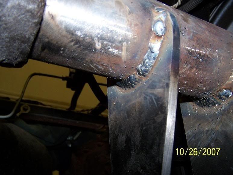

All my chassis work was done with the 3200HD lincoln.

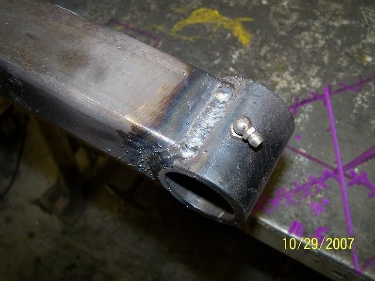

A lot of these guys are right about the 220 welder...but I have had a Millermatic 135 since I was 18 and have done so much with it that it puts to shame all of the "don't get a 110 welder it wont do anything" comments. I've used it in structural steel for buildings in a pinch and to build steel 4x4 decks, boat docks, build complete chassis, sheetmetal, and body work. So yes it can do them all and just fine IMO. Would I rather have a 220...yes, at the time I couldn't afford it and my garage wasn't wired for 220. Now it is and I have a big ass compressor and welder but poor people have poor ways and if that is all you can afford then get it. By ALL means though, do not get that hunk of junk they sell at Home Depot. As far as MIG welders go I like Miller a lot better and haven't seen a Lincoln perform as well as my Millmeratic 135.
