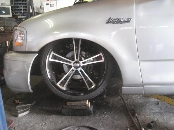

we actually didnt have to cust as much as anticipated, still has plenty of strengh, Although another problem arose with the brakebooster, we jucked up the wheel to see how far it will tuck and its stopping on the brakebooster, now its low as F*ck so we prolly wont have to go any lower, but what are my options as far as the booster goes??? here's a pic
BB
bill brasky
:You can put in the hydroboost. They make a kit for around 800.
Or if you are smart and can figure out how to do it the newer hd chevys have them.
An Explorer booster would work as well

My buddy is putting hyroboost on his s10, but thats just out of my budget right now, that drop is just with the jackstand and no bag, so maybe when we put the bag in it wont be as low and the brakebooster wont be a problem, the rims are 22" Panther Octanes, thanks, i like em too

i used an explorer booster when i bagged my buddies supercrew, i had to cut out less than half of his fender support and he layed 285/35/22's

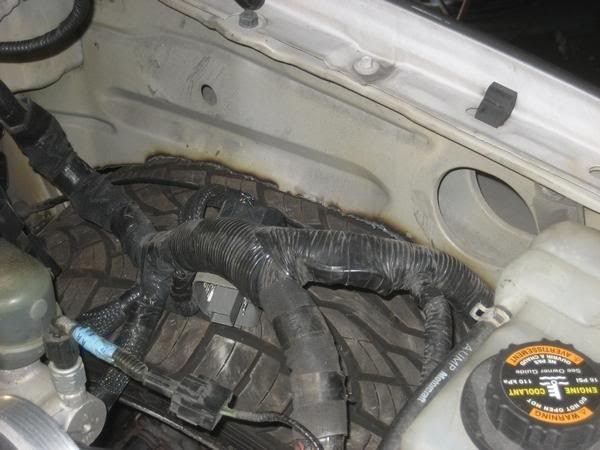

How was the explorer booster? work fine? yeah we didnt have to cut out too much either here's a pic before we clean it up

my buddies supercrew lays frame hard on a 265/35/22 with the stock booster & no tubbing of the firewall.
