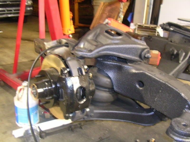

I have a mustang 2 setup on my 68 f100 moded to fit big bags.IF custom is getting ready to put a mustang 2 setup on a f100 unibody.Here is the crossmember almost done.
BAGGED 68 FORD's avatar
BAGGED 68 FORD

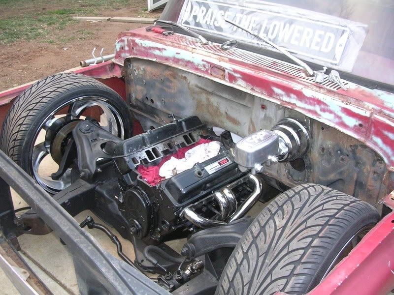

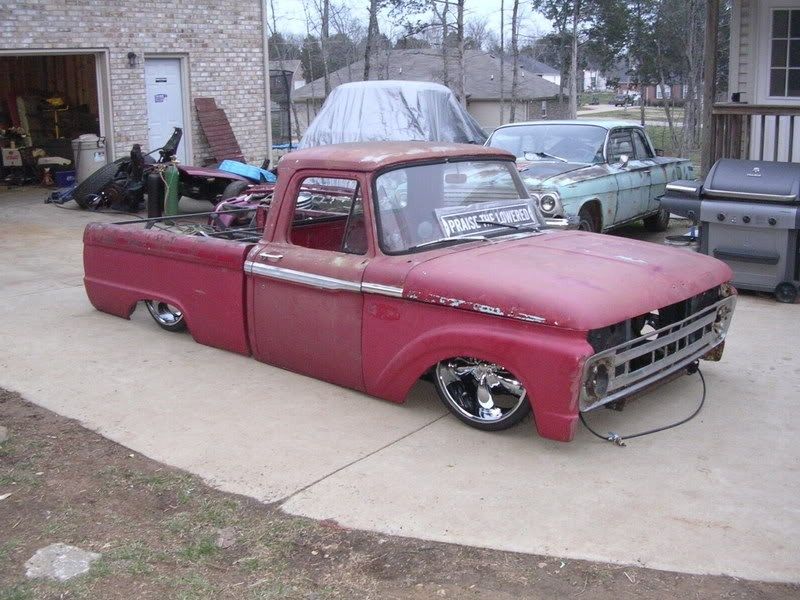

mines a 75 camaro. i beleive they're the same between 70-79 (something like that)
cut the frame off right in front of the cab mount and grafted the new one to it. then modded the frame to lay body
you can see some of the gussets here...
