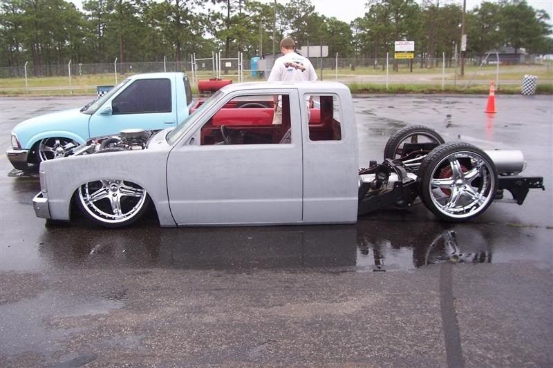

sadexcuse4s10
powerperformance balljoints don't bind up on pie cut uppers
and they look fine sandblasted and painted. They don't look any worse than the stock front frame clip.
plus, for less than $200 in drop spindles and balljoints I lay on 255/30/22.
sadexcuse4s10
Edited: 6/1/2008 6:33:17 PM by sadexcuse4s10
I powdercoated my link setup and bought a set of headers with the $ I saved on control arms.
