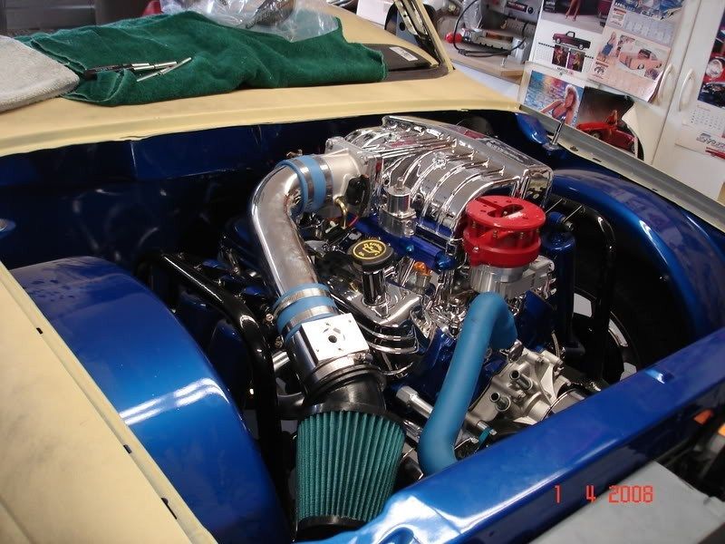

Not sure how good you can see in this pic. The regulator is right below the throttle body and the return comes out of that. The inlet is at the front. I am not sure if they can be interchanged due to injector spacing cause you might be able to swap to the driver side if needed. Good luck and let me know if you have any more questions.
