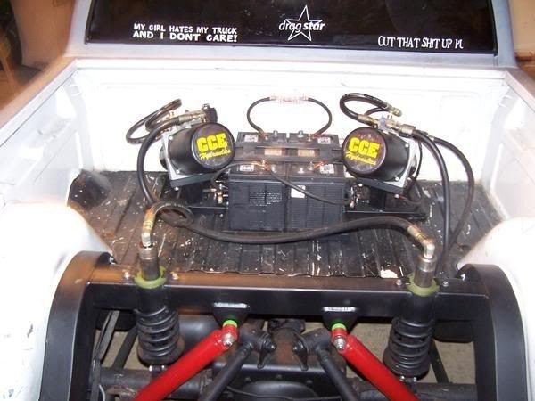

i dont have a most recent pic... but here is how it turned out ... we mounted the dual pump, single wammy tank right above the link tabs at the front (not pictured)
