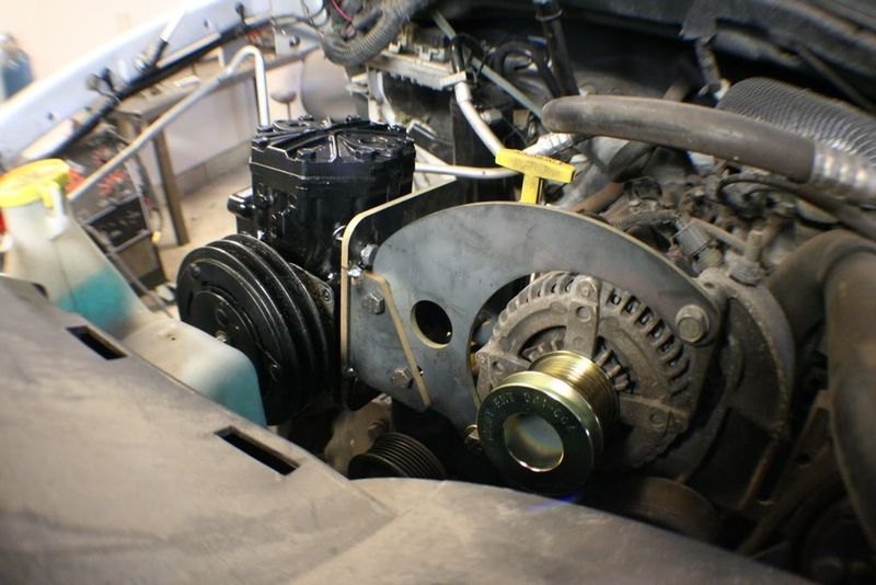

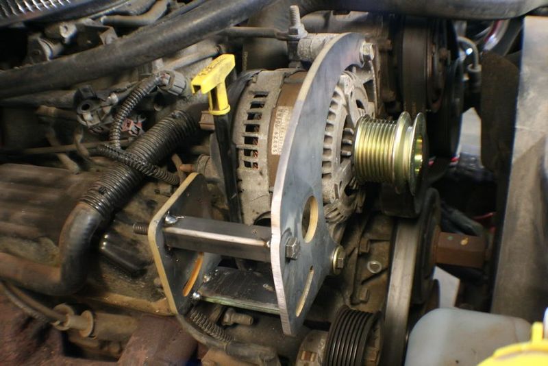

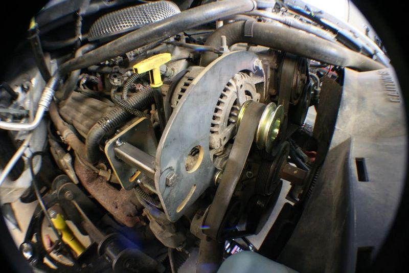

hey man.. nice truck.. whered u get the bracket at for the engine driven

--------------------------------------------- Originally posted by dodgeon26s hey man.. nice truck.. whered u get the bracket at for the engine driven --------------------------------------------- Taylor made that EDC bracket, if your interested hit him up on the email above.

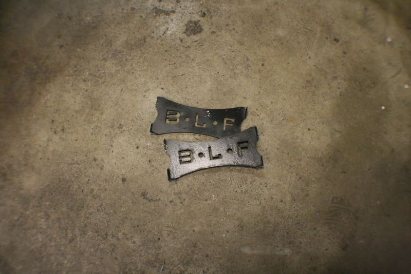

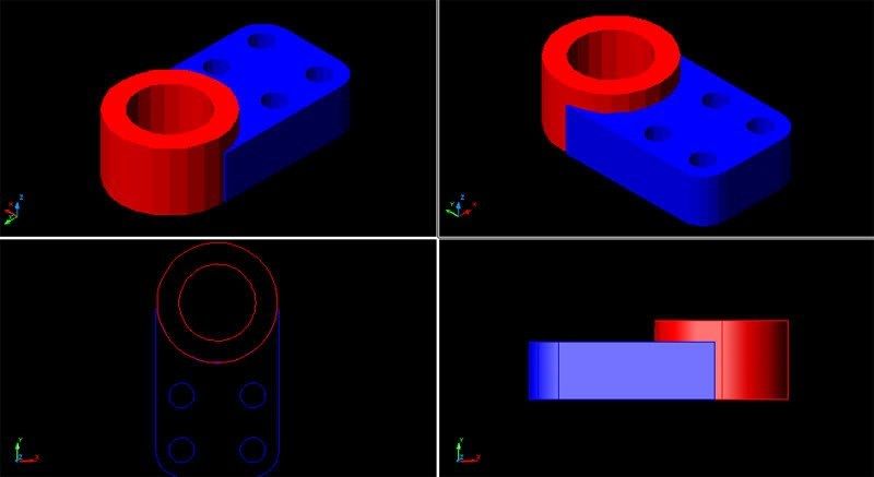

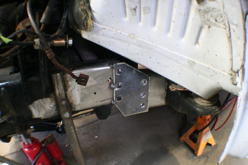

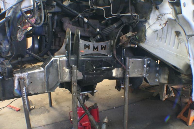

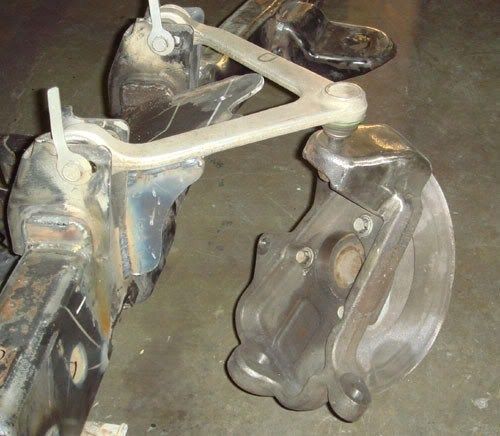

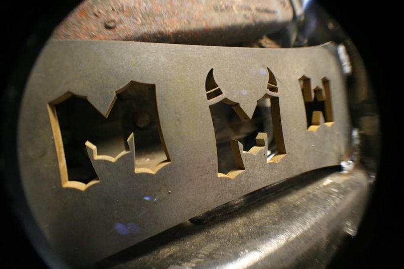

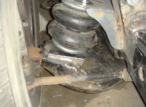

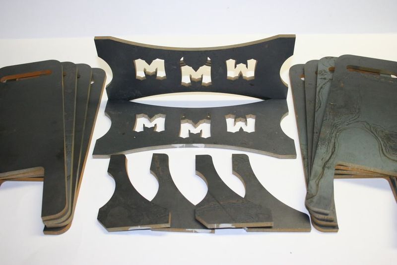

werd.     if you need hard to find dodge parts, like raised upper mounts, with gussets and center plates, flipped balljoint kits, flat plate lowers, flat plate uppers, edc brackets, front bag mounts for uppers and lowers with stock lower arms.     my email is tjjardas@gmail.com   all the stuff is cut on a waterjet machine, so the accuracy is dead on, and the parts come out nice!   heres a pic of the 3" raised upper arm kit:

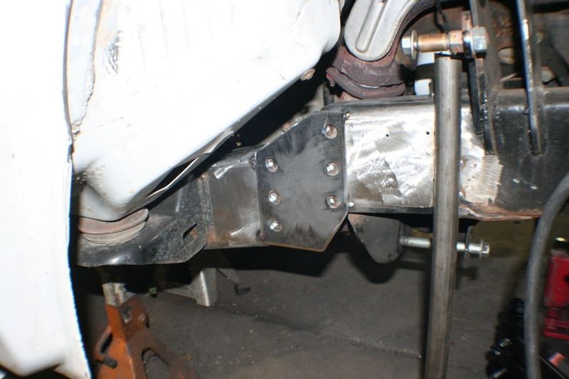

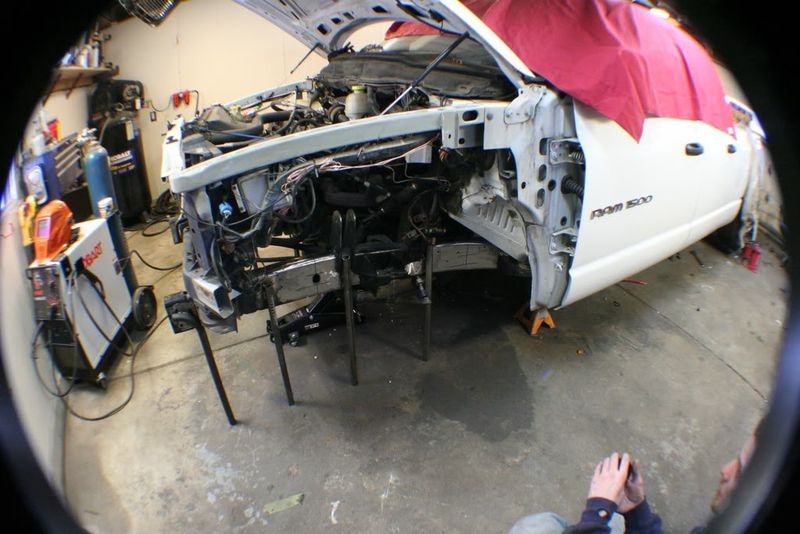

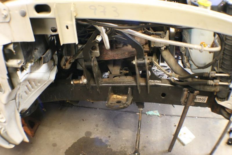

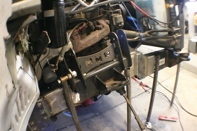

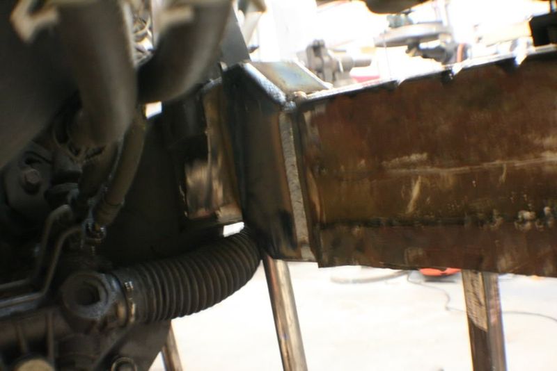

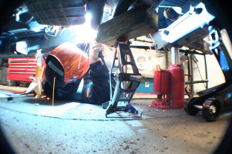

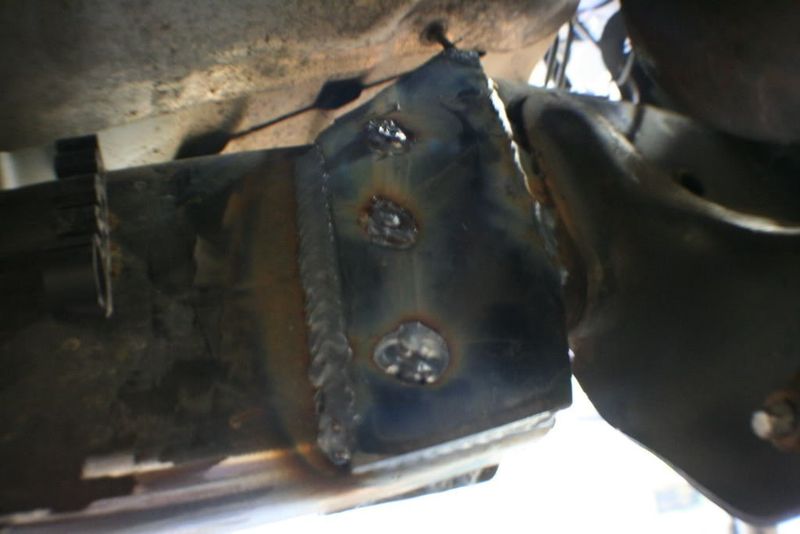

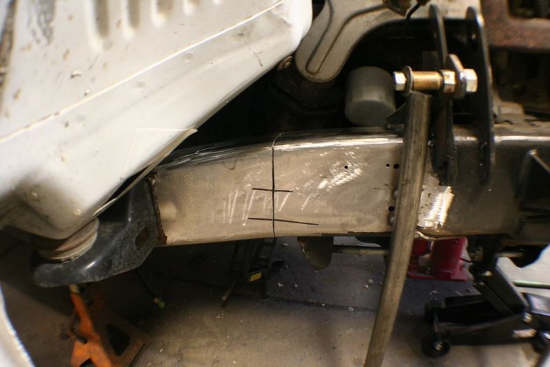

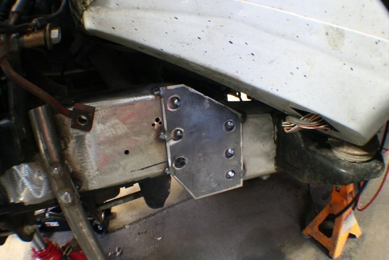

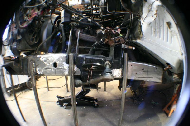

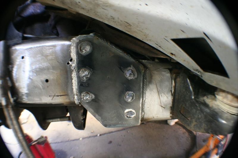

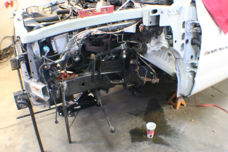

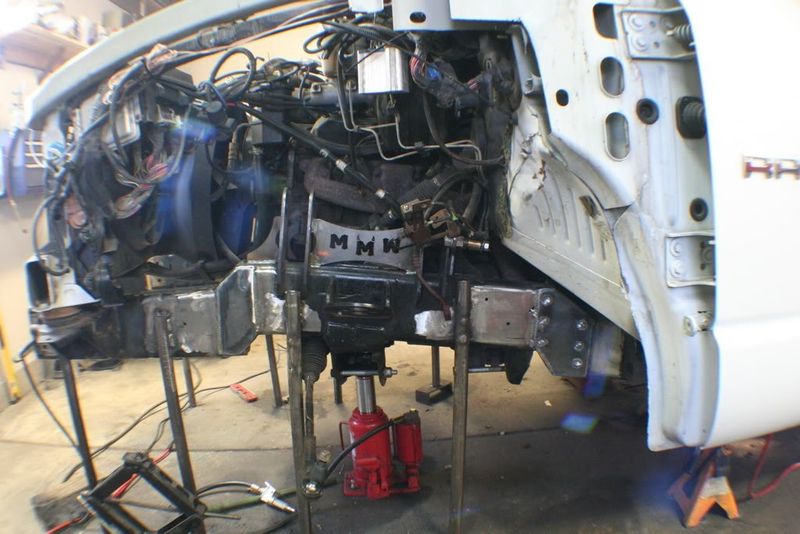

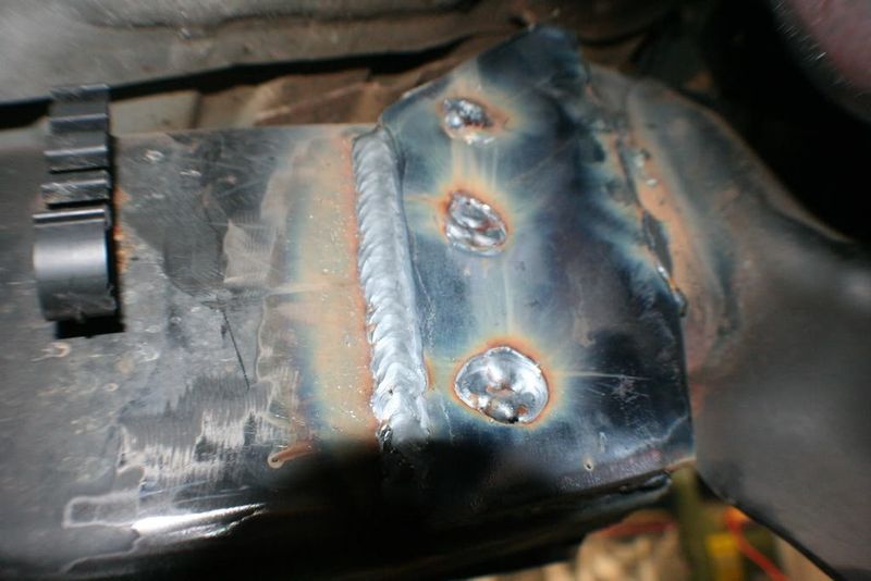

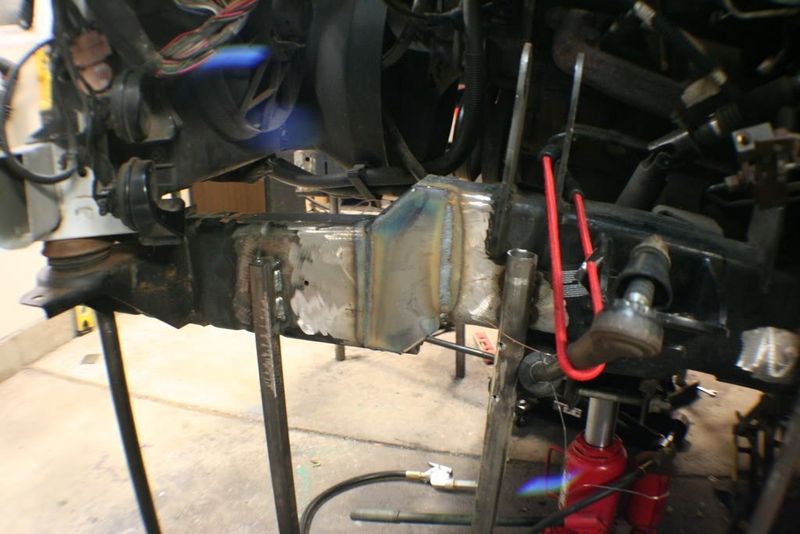

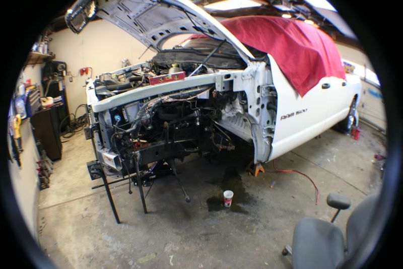

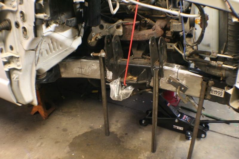

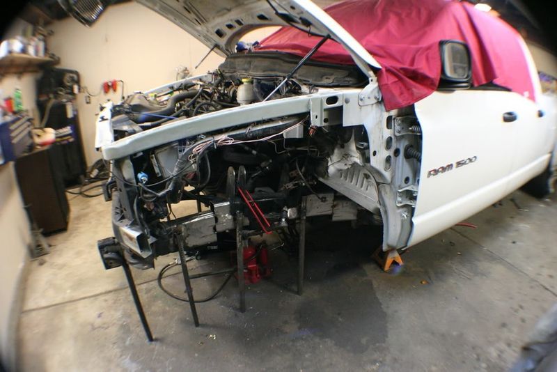

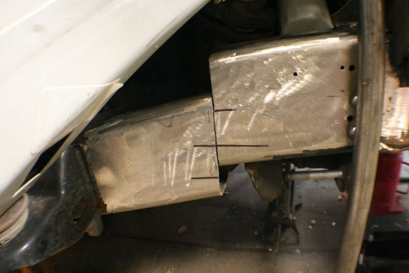

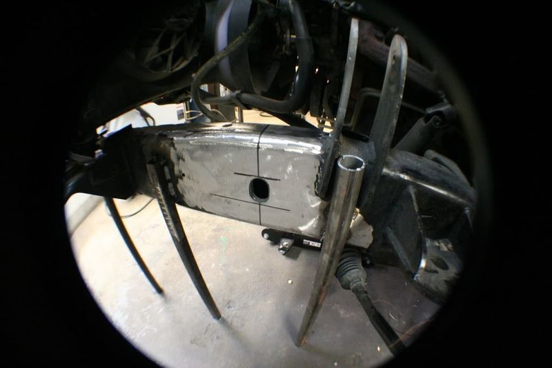

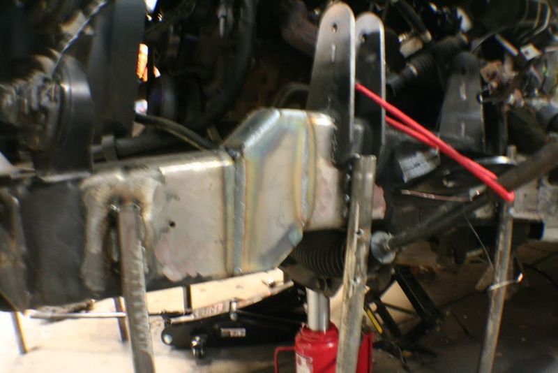

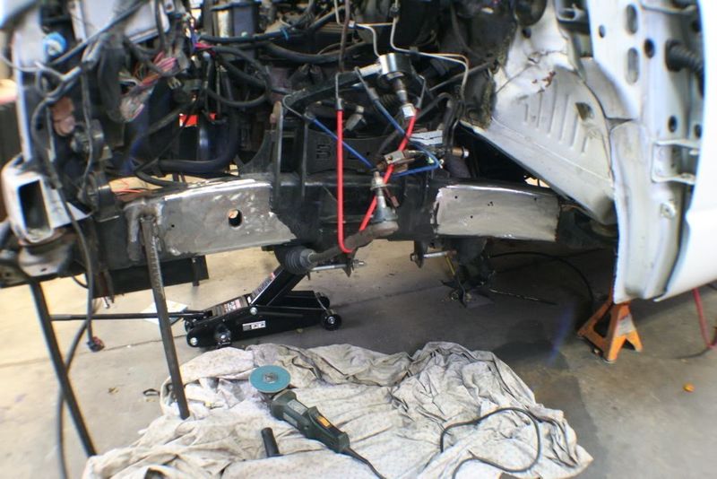

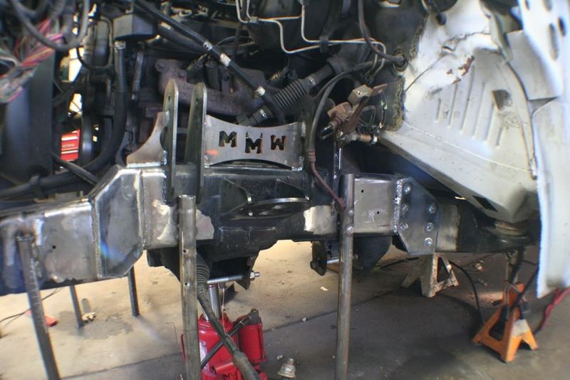

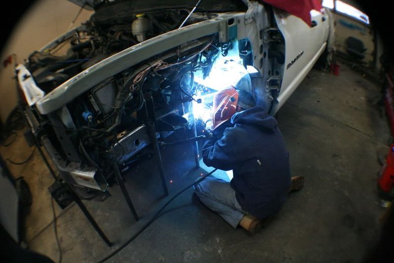

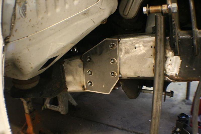

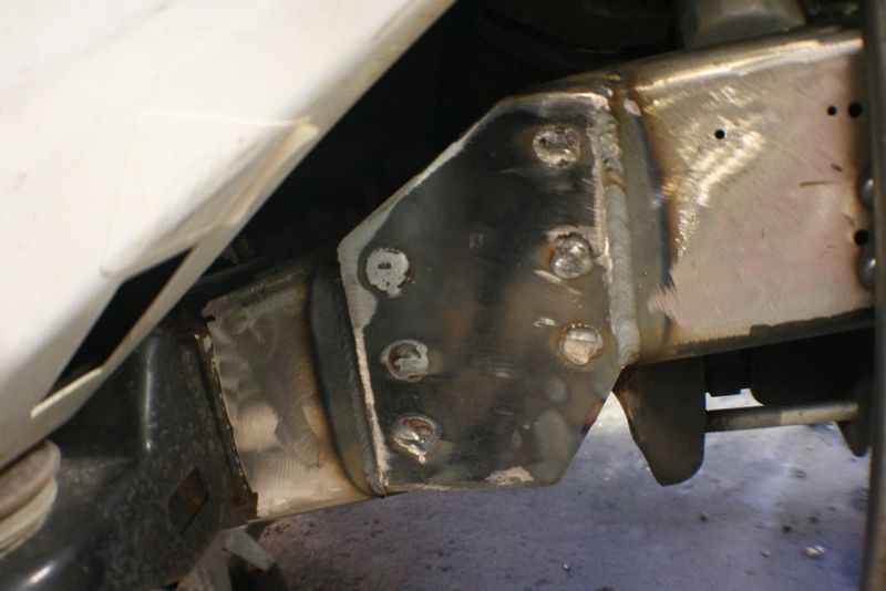

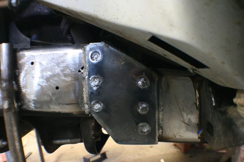

Thanks guys, here are some updates !!!   Uh. I couldnt sleep last night at all, i tried to go to bed around 10pm, becuse i had to work at 8am this morning.....but at around midnight i got up and went back out to the garage and kept workin till around 5am. IDK why, but this allways seems to happen atleast once or twice a winter when im workin on a project, i did manage to get a shit ton of work done tho, somehow i had every step that i wanted to do in orderin my mind, and it just all went smooth. I just got home from work, and im gonna head back out and see if i cant clean up that hack job of a batter box that i had in thare....... jaymee knows what im talkin about lol. I have alot of respect for the guys that "Z" these rams on a regular basis, the only time that i was in a proper welding postion was when i was doing the outside frame rails in the front, every other weld was VERY out of position, and they are very important welds because they are bassicly holding your truck together up front. But, i managed to get some good welds in thare with soem creative positioning lol. The rear "Z" gussets, i wanted to plug weld onto the frame also, so that it had alittle extra grab. It probably wasnt necessary, but i did it anyways for reassurance. I had to cut all these pieces up with a angle grinder and a cut off wheel, i had initally planned on shearing them to the correct shape when i went to work today, but again.....i couldnt sleep.
