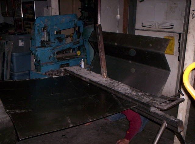

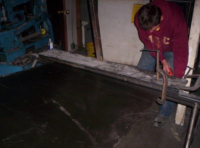

BAGGED 68 FORD's avatar
BAGGED 68 FORD
IF custom built this one, it works great.
