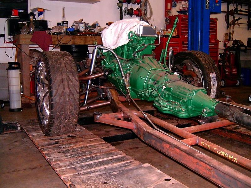

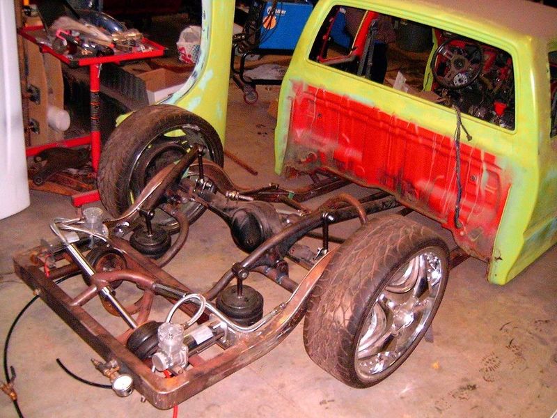

i have a hybrid setup for the front of my truck cylinders up front, with the bags pushing the cyliners in the back. gets atleast 15" of lift.
homebuilt
thats a ridiculously bad ass set up! thats what i need to do.
