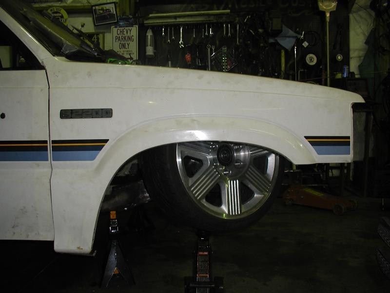

i'm putting 23's on my body drop f150 but the problem im having is if i turn the tire eats the fender. what do you have to do? i really could use some help quick and talking to someone on the phone would be great.
chris03hd's avatar
chris03hd
same issue with mine and 24's. looks sweet rolling so low tucking 24's, but there is just no way to turn correctly that low.
dortonracing's avatar
dortonracing
how did you fit the 24 in the fender? do you just raise it up to turn?
dortonracing
do people narrow up the arms or the frame up front. cause my tire looks like it a lot futher out then most?
still2low4urho's avatar
still2low4urho
what kind of offset do u have? and how wide is ur rim?
dssur's avatar
dssur
you can narrow the ams but because of the leverage setup on the front arms you will lose lift.
my wacky homie wiggity wayner narrowed his whole front frame and can turn lock to lock laid out.
dortonracing
the wheels is 10inches wide, with a 20mm offset. its a 23
daveg's avatar
daveg
not gonna be able to turn a whole lot, but u can shorten the c.arms and recess the bag into the frame or under it per say. that will help with it bein able to raise high enough...
N
NaviGangsta
my 24s are 9.5" wide with a 18mm offset
the lower is the same length as a DJM with the stock uppers that are moved up and in 2"
It BARELY clears... like cunt hair close
