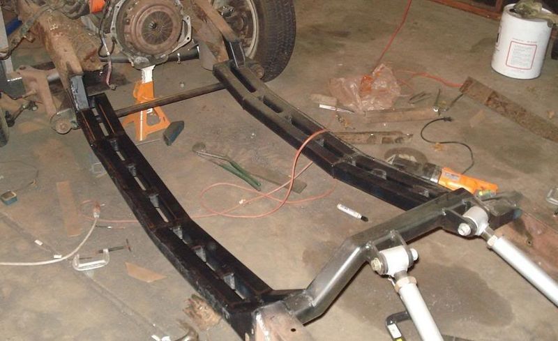

If you put 2 peices of 2x2 1/4" like you have and took 1 peice of 2x3 3/16 like they suggest and put them in a press to see what would bend first. The 2x2 would be stronger.
p3ug
The weak point is going to be where you tie into the stock frame. Make sure to plate/box it.

well i personally think that a single rail of 2x2 on a mini such as a mazduh or nissan would be sufficient enough to hold the weight of ur truck and any other mini. as long as u make the transition flow well, not just a straight drop it will be just fine. my 93 mazduh has a single rail of 2x2 down each side and it is very srtong no twisting or bowing, also my truck is back halfed with 2x2 as well so what u have is very strong and very safe so go ahead and plate the inside and call it done ...

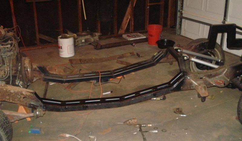

little update still needs work,

That is plenty strong enough. I like the idea.

This is the weakest part of your frame.
bmini94
yes definately weld a piece where the stock frame kicks up then connect that to the inner 2x2 and box it all in
sluginxlt
yeah i know that part is week, i havent got that far yet, look at the first pics in the thread, that peice wasnt welded in yet, and then im gonna box it in probably... sound aright?
