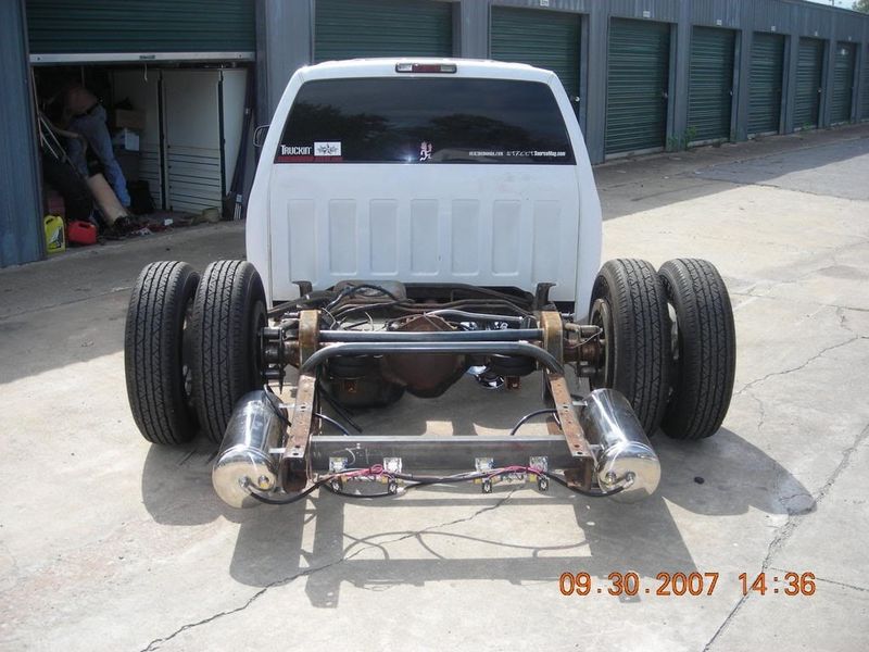

does anny body have pics of there rear setup on a 1 ton thanksthis is mine, I tow with it very often, no problems yet but I'm going to change out the panhard for a watts soon. bags are slam re-8

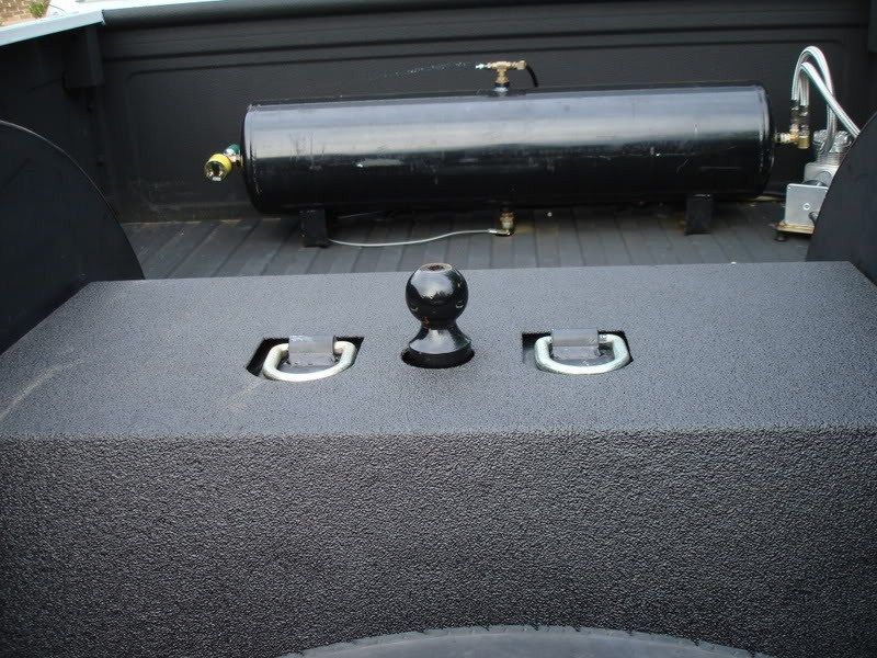

thanks on your fith wheel ball setup you just welded it to the tubing?

yes, it was a plate with a nut welded underneath and the ball has a 1/2 drive so it is removable. I welded that 1/2 plate inbetween my bridge which is 1 1/2 .250 wall it also ties into my bag brackets

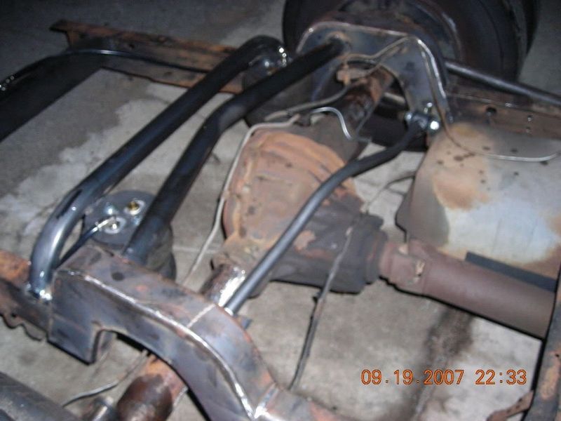

Here is mine...bags behind rearend parallel 4-link w/ panhard bar on front of rear end. No problems so far..Slam bags as well...

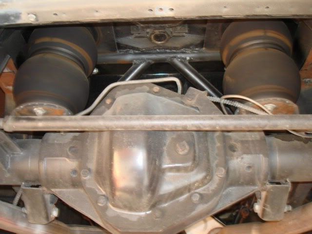

I have a bolt one 4 link with sleeves behind the rear end. It will lift more than it will haul...
