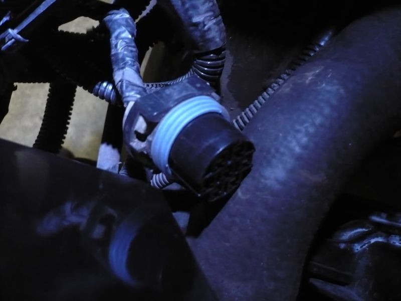

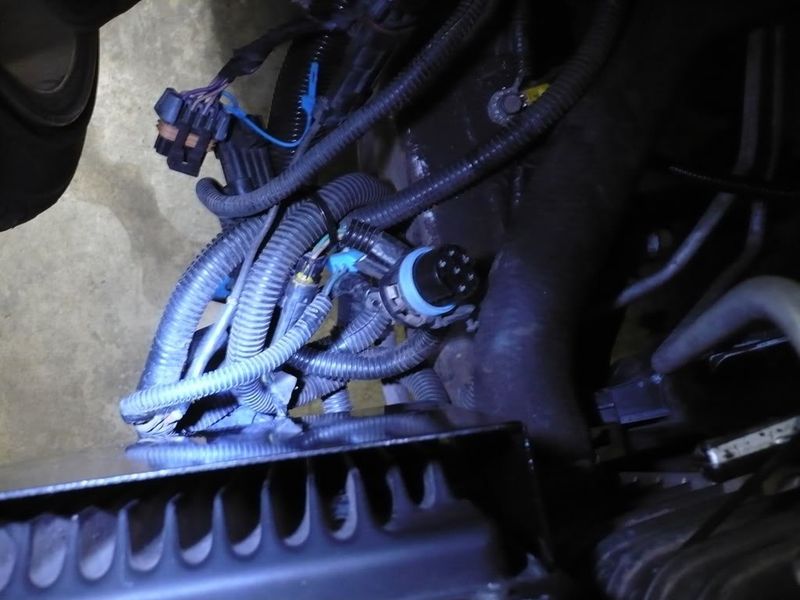

What is this plug? I thought it was only heater power stuff, wrong?Inside plug-

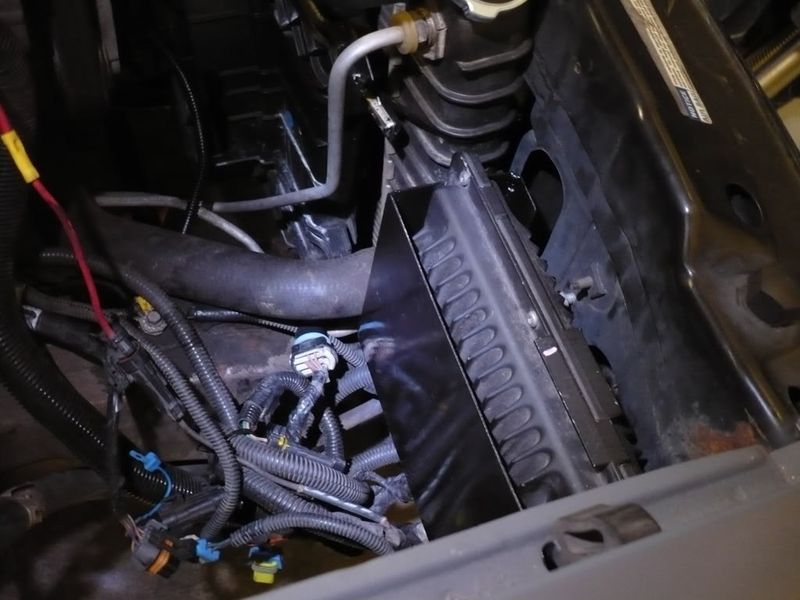

ECM Bracket-

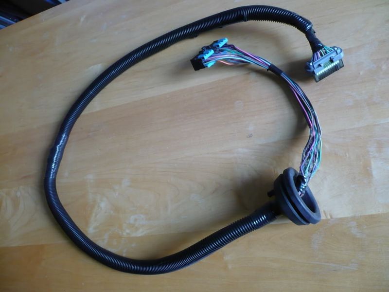

Harness i made-

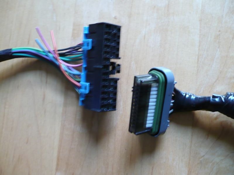

The plugs at each end-

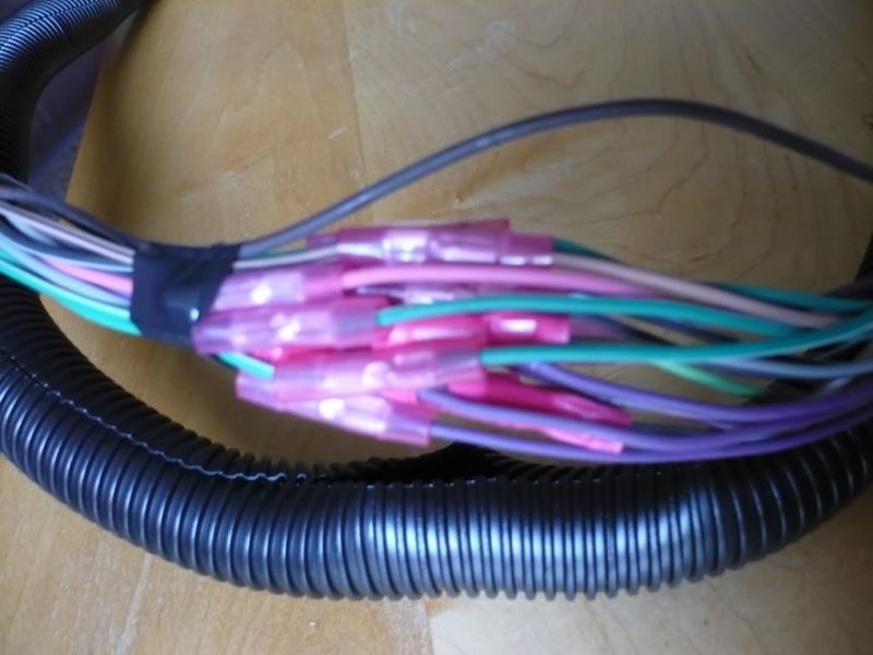

My connections-
