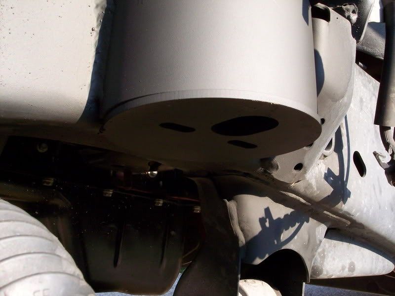

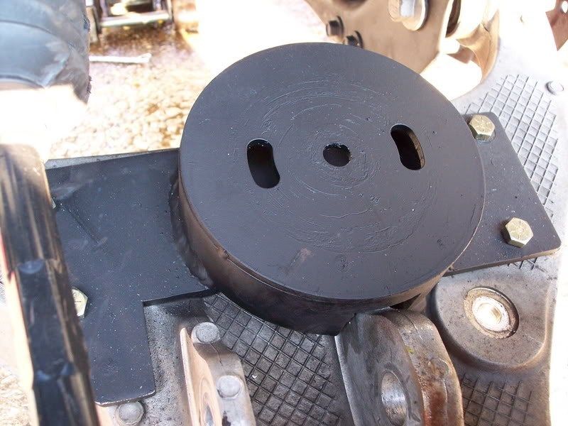

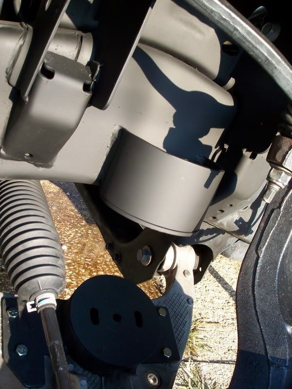

Here's some pics of how I did my 07. I had the ART kit on there but wanted to see how it would do with something different. I bolted a braket I made to the lower arm. No strenght integrity was lost in this process. And I also just welded in a cup up top. With the exception of cutting off the top, they both can be taken off to return the truck to stock or to the ART setup. I lost my sway bar doing it this way but it stil rides just fine. I would HIGHLY suggest check valves for the front either way you do it. AND also if your interested I have a BRAND NEW set of shockwaves sitting in the box for ART that I'd be willing to sell for $600 shipped.
