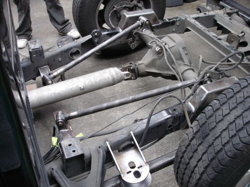

Here is a real good picture of the back the only thing not done in the picture is the drive line hoop. Dont know if you wanted to see but trying to help you out!
