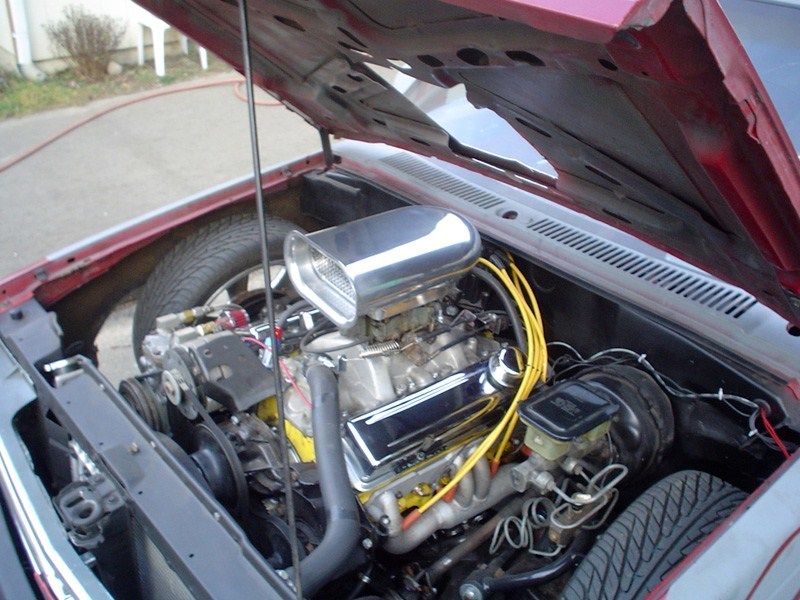

heres the headmans in my daily driver. its not body dropped and sits on 225 45 18s. no clearance issues anywhere. trust me they are junk. my other truck is body dropped and set up for slick fit. sorry no pics at the moment. but when i was doing the swap i hit a brick wall with the exhaust issues. lol i searched every damn profile till i saw dougs on his blazer.
