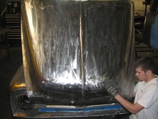

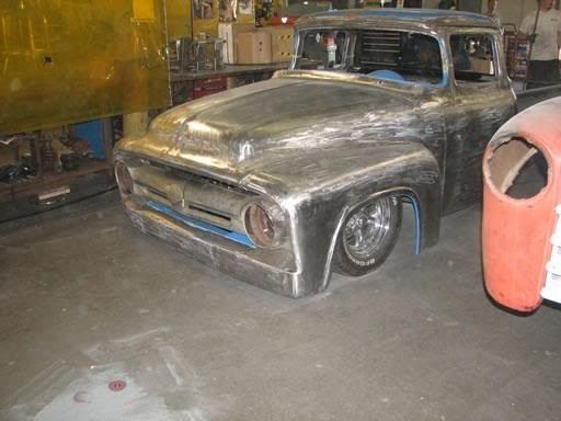

I see DIB and Grant with these trucks down to bare metal at shows and was just wondering how they kepp them up and from rusting? Ive herd that they use WD40 and was wondering if this is true? If so how much do they put on and how often? If thats not what they use could someone help me and let me know how to keep it up cause im aboutto be taking mine down to that stage, thanks.

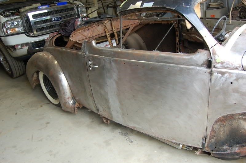

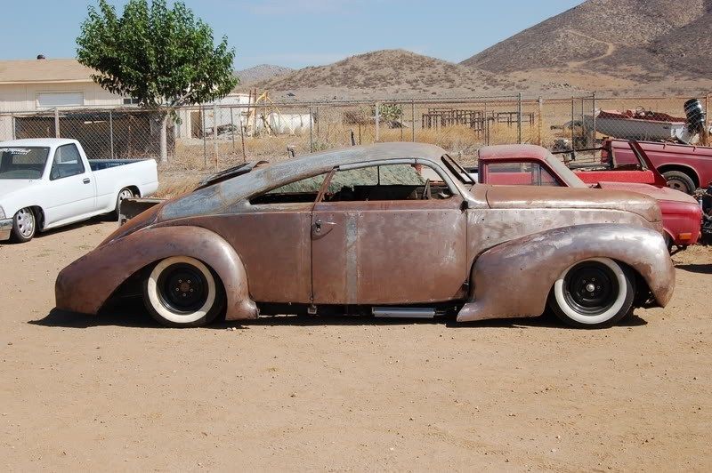

Here is a car when we first stripped it and only 2 months later...

off topic but that car is BAD!!
datsunlayingdoors's avatar
datsunlayingdoors
also in those pics you need to keep in mind that max is on the west coast.. over here on the east coast that car would be twice that bad just to the freaking humidity we have here
