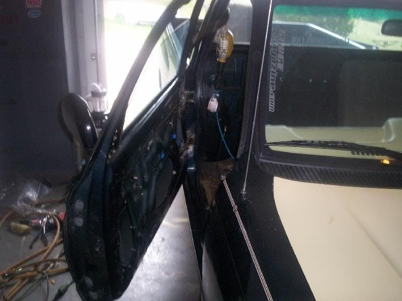

Edited: 8/19/2007 7:37:21 PM by SCR8PIN92YOTA
here is mine so far my hinges came from auto loc and they seem to be really nice so far
