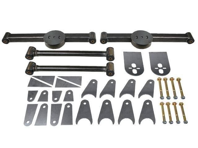

I know a 4 link would be great but I found a ranger that already has djm flip kit and belltech drop leafs, i would only have to add the blocks.
I was just trying to do it cheap for a daily driver.
