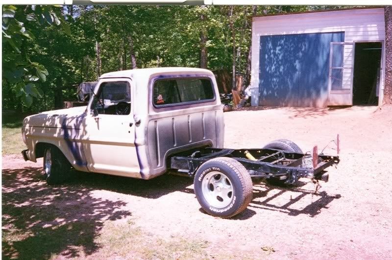

here is my truck back in the day 7/3/03 when my truck had actual paint on most of it. This with a 16 inch rim but the same as the 17 talked about above. i did a weld in c-notch mono leafed with the torque sping still and 4 inch angled blocks. I also added plate around it cause it looked weak to start with. before i decided to cut it i had a dint were the axle would hit the bed.with that and some rear mounted bags on some bars i could three wheel.

Thanks for the info. Brad, his truck looks just like yours but ex-cab. Very similar wheels also.

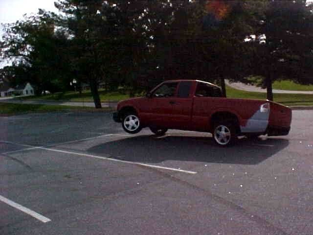

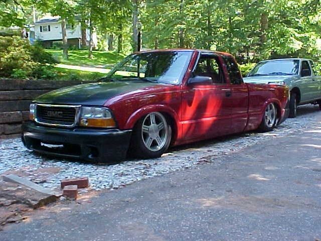

I laid out on 18's with my s-10 with no hole in the bed...just a small notch
