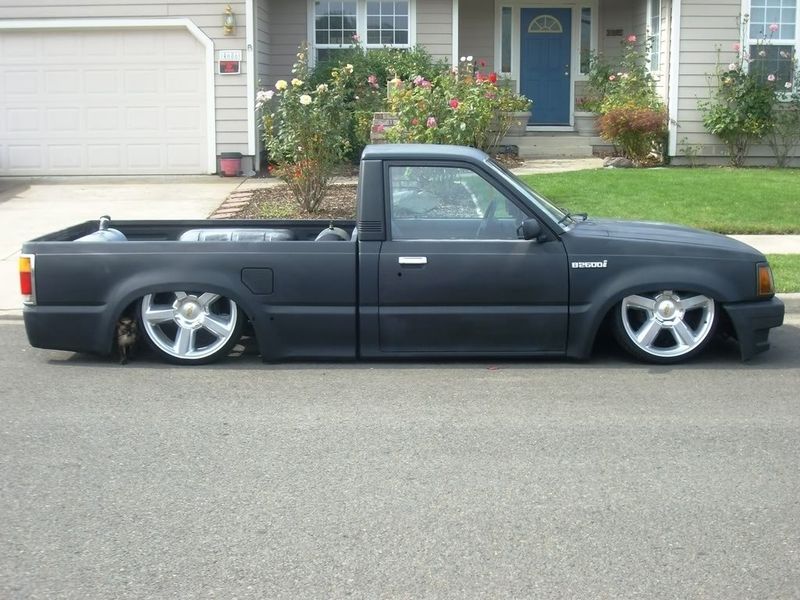

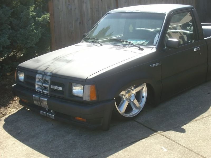

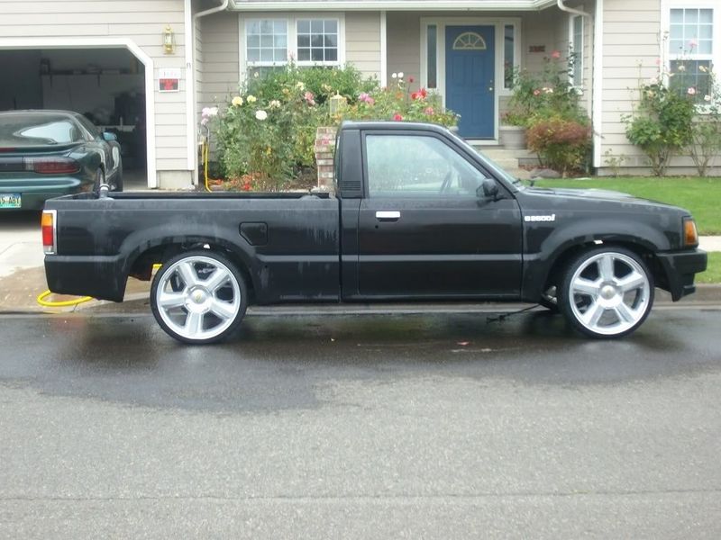

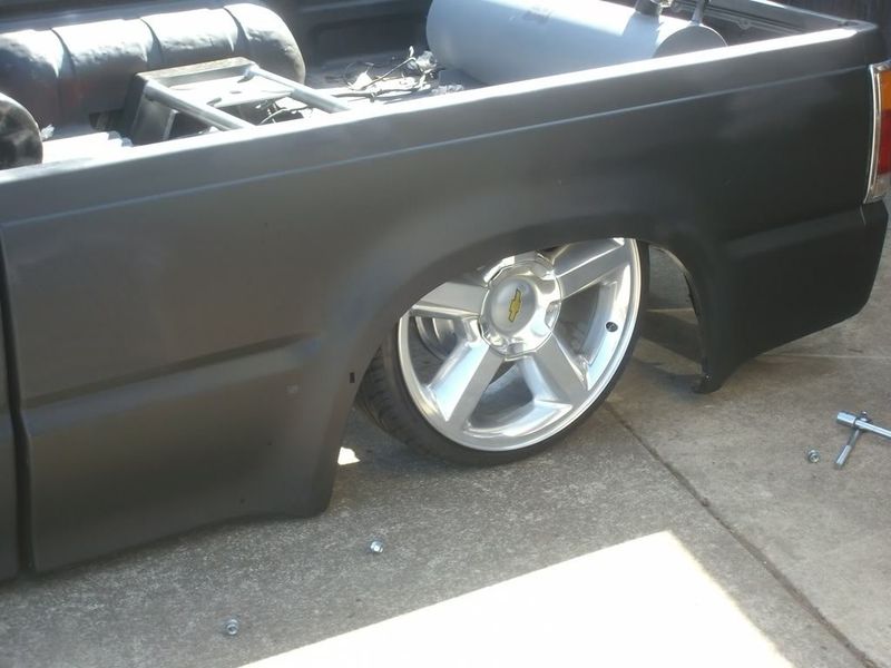

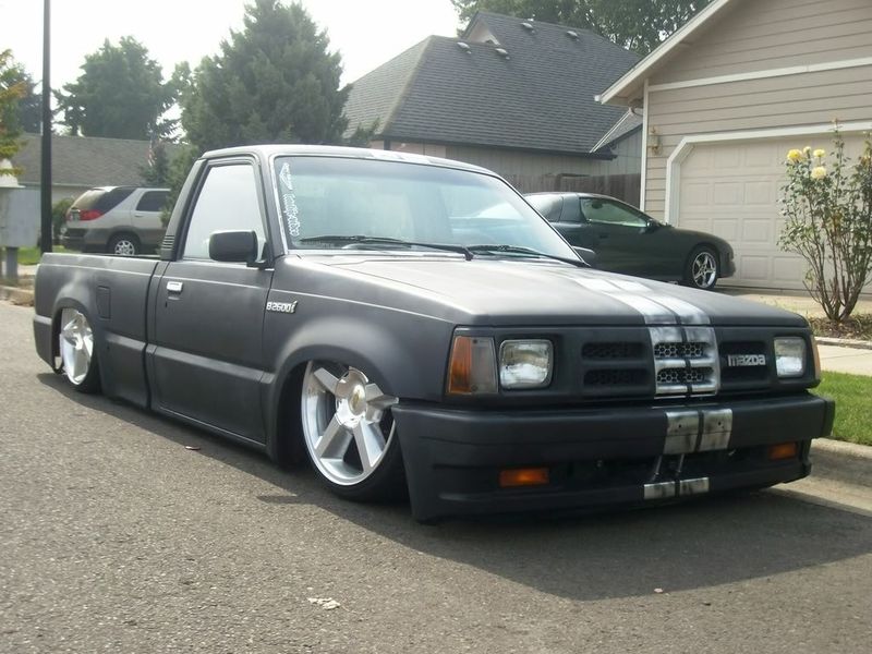

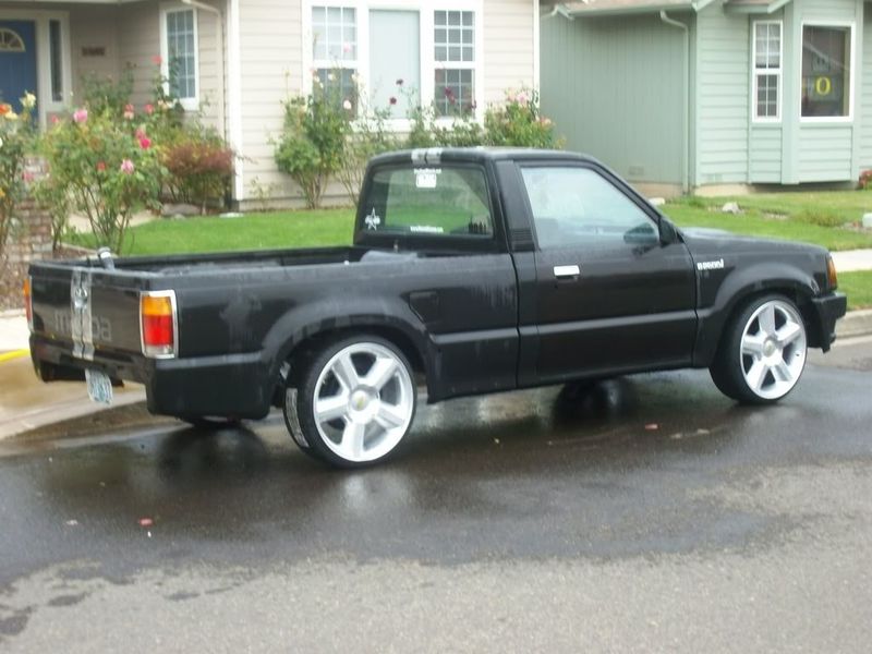

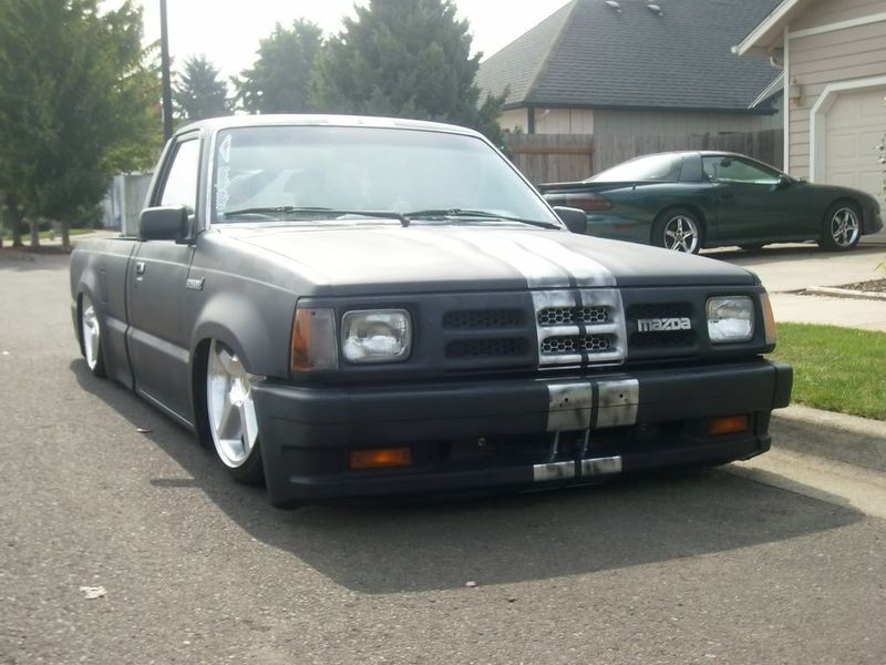

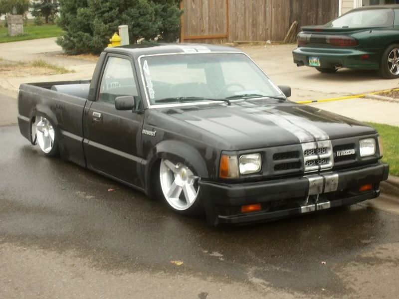

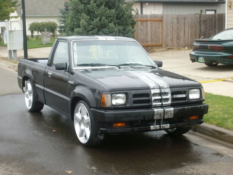

Not going to fit 2wd gear with out major work you will have to narrowed the rear end or get a rear end out of a courier and some major work will be needed for the front to clear 2wd fenders they just clear 4wd gear. The tires are screwed up the shop gave me 3 passenger side and 1 driver side. It's not going any were for awhile so i will deal with it later. the 4 link needs to be adjusted a bit that why its not completly center on full lift.

THAT LOOKS GREAT! The cat in the one pic is the funny as hell!

I did not see the cat until after I posted the photos. First thing i thought was darn its still not low enough if he can fit under there.....

I have 20 x 8.5 with a +30 and they tuck in the front with 4x4 metal with rolled lips but gona have to narrow the rearend to tuck the rear.

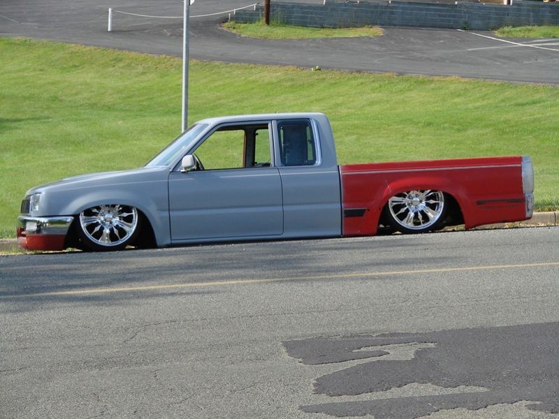

im running 20 x 8.5 dunno the offset but the backspacing is 6" heres a pic of mine, sorry if pic is to big
