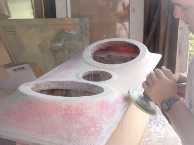

im hoping he added matt and resin over the fleece, but it sure isn't pictured...

stop following me around LOL my god. fact of the matter is, if there is no matt over the fleece, he needs to do a LOT more work than what was done. If it is, then it should be fine, he pictured every step but matt.

Here's your answer to the resin on the fleece question. You obviously dont sand fleece. You sand bondo over glass!!
The box has 2.3 cubes per sub. It sounds awesome. It is a temp box while we build a molded fiberglass enclosure.
You can get all the specs on the subs at www.addictive-audio.com they are the version 3 12's!
granth
looks to me like you layed resin on the fleece, and layed bondo over that...and if there is glass on there, its not enough. but what do i know.
next box you make, for that heavy of a sub, and the potential you say it has, the glass needs to be like a 1/4 inch thick.

There is alot of glass and resin. You can stand on this thing I am 250lbs and put all my weight on it, no problem! It sounds great and that's what matters right?
fair enough. i guess this is one of those "pictures dont do justive" deals. I love the box design and placement though, just add some port to the final box. you need like 4 of those 4 inch aeros to be about right.
