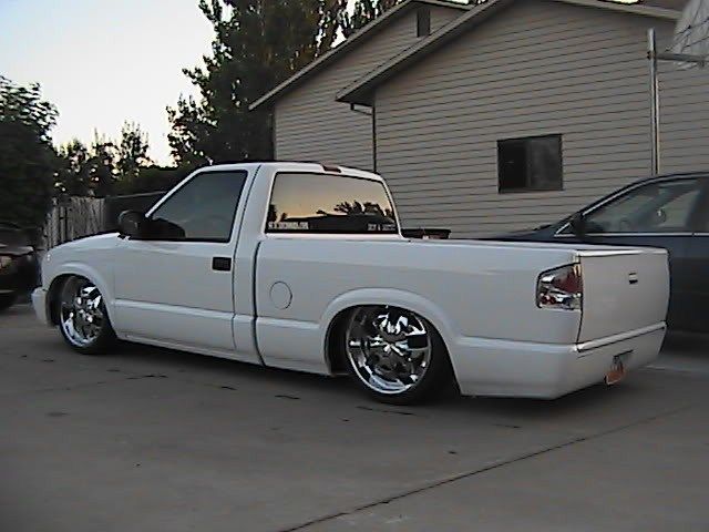

i have 255/35/20 and my shit rubs only really low or when i drag

you will have to notch for your driveshaft. You will rub when driving really low, like draggin height.

You will for sure have to cut for drive shaft, unless you adjust your pinion to point straight at the ground. LOL jk I run the same tires and it hit the cab around 1 1/2" to frame. And you'll need wheel tubs if you haven't already done so.

mine use to rub, and it made the worst noise possible but when i got under there to look it was just a spot on the bottom of the cab floor smaller than a dime. call me ghetto but i just took the driveshaft off and jacked up a bottle jack at the spot of rub and bent the floor enough to clear. GOOD LUCK

It hit cab and didn't even lay frame yet.
