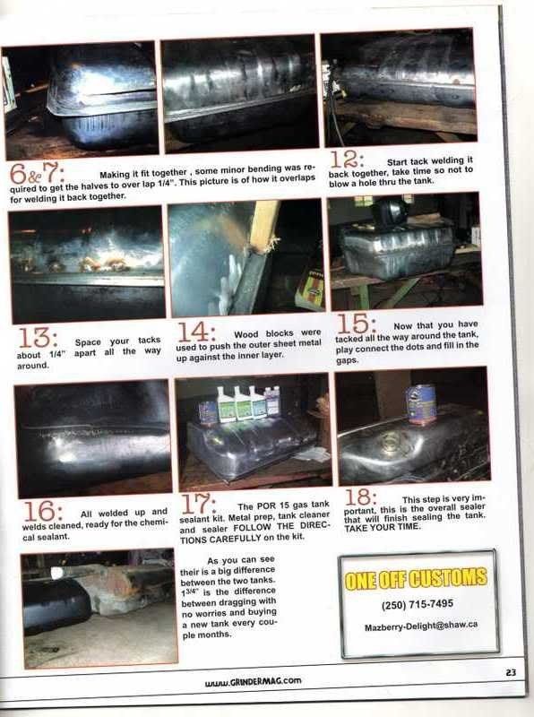

anyone got pics or could explain how they did thiers? mines too wide to put between the frame rails. also would it still read the same since i wouldnt be messing with anything really?

kuts r us did mine in my izuzu basically the idea is to measure the height you want it at. then remove the tank. drain the gas. rinse it out. cut the section out and re weld it solid then use a gas tank sealer. reinstall i lost about 2 gallons of tank room in mine not to bad at all.

here you go...compliments of the guys at Grinder Magazine..

thanks, just what i wanted to see.
