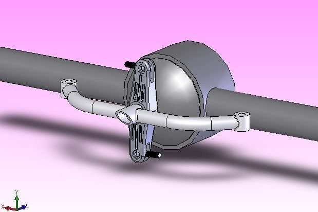

I ripped off tp's design for mine. the centerlink is cnc machined alum with pressed in trailer bearings the bar is 1.5" dom with a machined centerlink. and my heims are 5/8" chromoly pieces from ballistic.

im not sure but isnt it supposed to be at half travel rather than at ride height, cuz hell ride height could be ANY height! im just learning so dont get pissy but i just thought i heard that somewhere. am i right or wrong?
