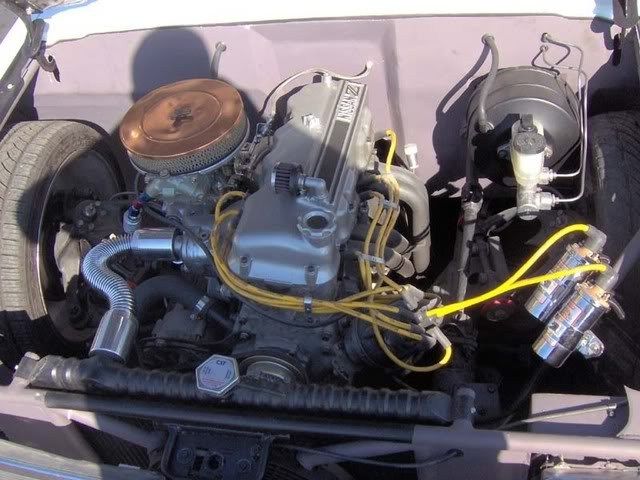

with my 720 i took and made an arm that pushes the opposite direction so my master cylinder is backwards and is filled under the wiper cowl
